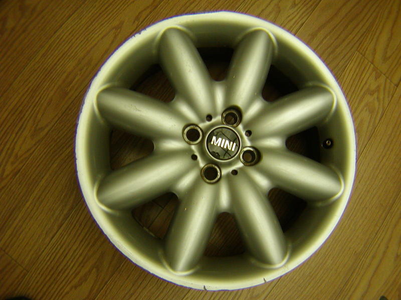

My current tires are the original run-flat tires and the fronts are basically gone, and the rears are maybe 3/32, if that.
Current tires are 205/45/17 on stock OEM rims... they look like this.
My suspension is still the stock sport suspension.
I want to switch to non-run flat tires at 215/45/17. I did a search on this forum, and it seems that a lot of people were able to do it without problems.
However, I ran into this post while searching, and this guy said that the tire rubs. I don't know if that will happen to me. Will that be an issue with me or should I stick to 205/45's?

215's will fit great with just about anything with a offset 40+. 37-40 fits some cars, and others need simple trimming to fit.]Pirelli Cinturato P7 All-season would be the best ride quality/low noise offered in your size. You rotate to all 4 corners of the car to keep it very quiet. Take a closer look to our customer surveys on this tire

215/45-17 will fit, no rubbing with stock suspension and OEM wheels.

Thanks for the advice, guys. When I got the confirmation that the tires won't rub, I went the tire shop yesterday. They didn't have Pirelli tires in my size (or hankook), they did have contini sport touring (sp?) Tires in stock. I'm good friends with the guy, and he got me a great price... $83 install price per tire, plus a $60 alignment.
The car feels like a new car now. I didn't realize just how loud the old tires was... I can actually hold a normal conversation without going "what?" every few minutes. The car doesn't feel dramatically more comfortable, but the ride quality is different enough that I'm not having every single crack in the asphalt etched into my spine. The tires have definitely smoothed out the roads.
