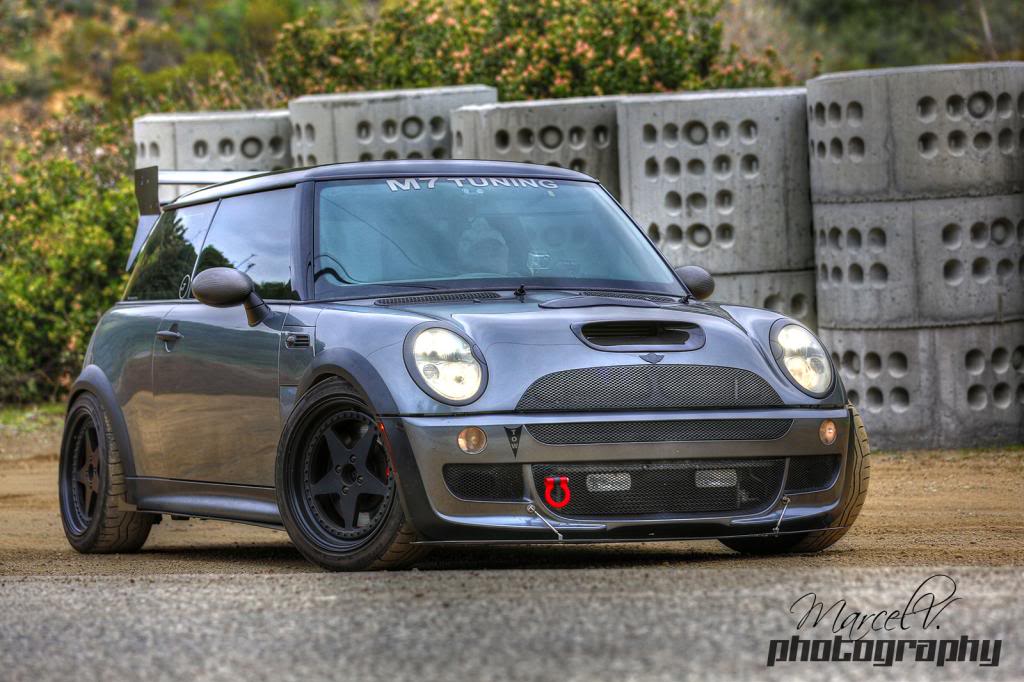

I run a 215/45/17 rival and I am about 1.75 lower than stock with minimal rubbing . Rim width is 8 inches.

2002. R53
M7 coilovers
1.5 neg front street push to 3.0 neg for spirited cyn and track with adj plates .
Rears 1.5 neg .
If I am in a tight left hand turn and incur a dip I will slightly rub the outside edge of the right rear . Been the same way for 10 years now so I can live with it
It does the same thing with my other street wheels which are 17/8 Hammans with a 42 off set and 215/45 BFG KDW/2 tires.

After 11 years with the same car you begin to figure things out . You are correct about the plastic liner sections . You can get under there with a small grinder or let nature take its course . Rubber beats plastic eventually
As the rivals are new I don't have any decent photos as yet but these two are with same wheels as are currently on the car but with a set of Falken RT 615's which have the exact same minor contact issue so I think the profile must be quite close .
I agree on the 225's , there is no way I could swing those and still be able to drive where and and in the manner I am accustomed to .
