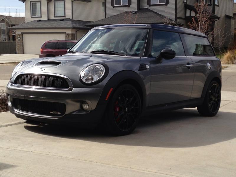

I have a 2010 JCW Clubman that is in dire need of tires. I have the original set of P Zero run flats on it. My dilemma is that this car has 205 40 R18's on it. I would like to put Michelin Pilot Super Sports on it but..... Michelin is back ordered on this size in Canada and the US. Tires are 6 to 8 weeks away. I have checked every online store and retail stores to find them. As I posted in the clubman section has anyone tried using 215 40 R18's? This size is more common and readily available . I have tried searching this site for that combo with no results. I'm wondering if this would result in rubbing or loss of performance ? The larger tire is not much more than 5/16" wider and taller! Input is appreciated .

For future reference, 215/40-18 has a taller than stock tire diameter of 24.8" but it will fit the OEM rim and stock suspension. A lowered MINI would/may have trouble with clearance/rubbing.

I just checked TireRack, and it lists 205-40-18s in stock:
http://www.tirerack.com/tires/TireSe...40&diameter=18
215-40-18 size has more options, but in this size Michelin PSS's are more expensive ($231 vs $170/each):
215 tires will be 1.29% taller and 10mm wider.
They should fit just fine.
As a reference point, I'm running 225-50-16 autoX tires (wider than yours, identical circumference) with zero rubbing under full load.
Both 215-40 and 205-18 sizes show in stock on TireRack, ETA shipping for those of us in the US is T+2 business days. Time for the road trip down south, eh?
