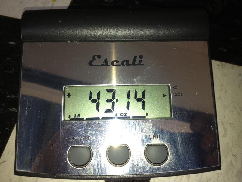

I happen to be a my brothers house till tomorrow and he has a quality weight gauge, can somebody tell me the torque specifications on the wheel bolts?

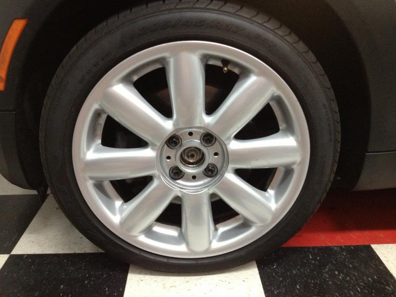

The Pirelli P Zero Run Flats (205/45-17) are 22lbs if the website is correct, this means that my Mini wheels are 21.14 pounds. Compare that with the Breyton Race GTS-R 17.6lbs, will I gain any faster acceleration with these wheels with and without run flats?

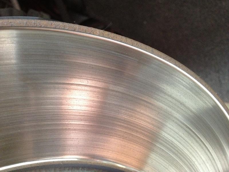

My rotors on the other hand are now deep dish rotors, changing them soon! This explains all the break dust that I have been complaining about, perhaps it's worse than normal. They are below spec, I have the Mini Sport drilled and slotted rotors at home, all I need are the pads.
Let's see if I came close, I used 85 ft.lbs, it could also be 103 ft.lbs
