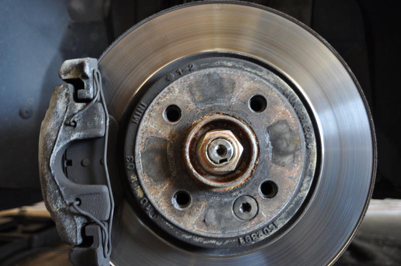

Hi don't mean to hijack your post but I have a similar question. I have a 2004 JCW. how can I tell if it is has JCW brakes or just R53 brakes. the front rotors are 11 in diameter. Ive attached a couple pics. thanks for your help.

R53 JCW and R56 S brake rotors are 294 mm diameter.
I think its 279mm (11 inch) for R53 S (non-JCW).
R53 JCW calipers are red.
Looks like those are regular R53 calipers and rotors.

Look like the stock brakes. The JCW "Red" brakes were an upgraded option at that time.
The Stock rotor size for Gen 1 R50 r52 r53 fronts are 276x22 or about 10.86".
The JCW Rotor size for Gen 1 R50 R52 R53 fronst are 294x22 or about 11.57"
