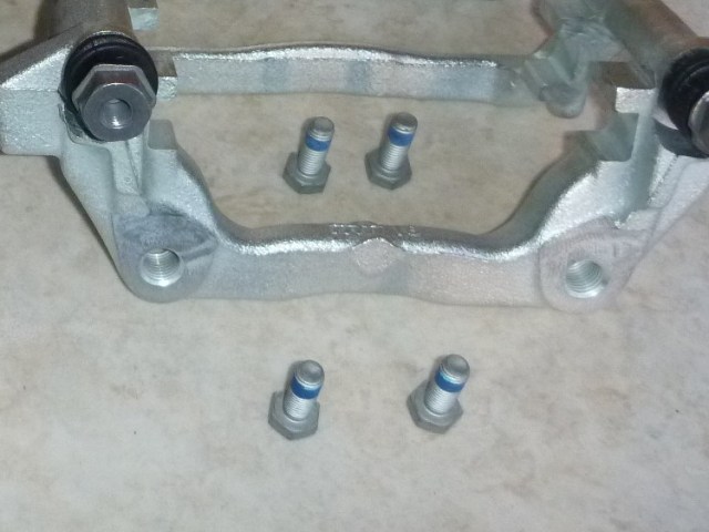

I suspect BMW say that because they supply one new bolt with each pair of pads and it already has a band of threadlock around it - so I think it isn't the bolt that's a one-use item but the threadlock band.
And BMW supply only one bolt as their method is to only undo the bottom bolt and then rotate the caliper around the top bolt.
Attached Thumbnails Don't reuse rear caliper bolts?  Missing brake wear sensor-caliper-bolt.jpg

Angib is correct. One bolt per side for front pads. Two bolts per side for rear pads. The thread lock is "one time use". If it were detrimental to the vehicle ALL cars would have thread lock on they're caliper bolts
