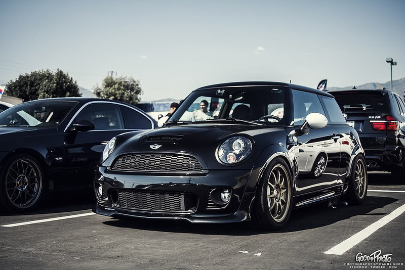

I'm running 225/45/17 on Volk CE28N 17x7.5 +43 offset w/ 5mm spacers up front to clear my Stoptech BBK.
Camber @ -1.5 up front and they don't rub. And yes, these wheels weigh 14.4lbs.

thanks for the info. i beleive the rse05's have +45 offset, so maybe i can get away without the spacers and camber. i do have drilled and slotted rotors with ceramic pads, but they are the stock size with stock calipers so clearance shouldnt be an issue there. is your car lowered as well?
Old Mar 10, 2013 | 03:23 PM
ra2fanatic's Avatar
ra2fanatic
Joined: Feb 2010
Posts: 2,936
Likes: 22
From: SoCal
this low enough for ya?
Old Mar 10, 2013 | 03:30 PM
RA082324's Avatar
RA082324
Joined: Jan 2012
Posts: 470
haha yea. looks nice. i really wana get my trim painted like that. did you diy?
