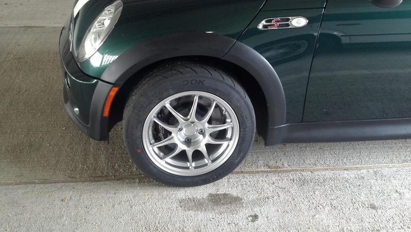

15x8 ET 35 Enkei PF01 with 225/45/15 Hankook RS-3
20mm spacers Front
5mm spacers Rear
also posted some pics here:
https://www.northamericanmotoring.co...6-post159.html
