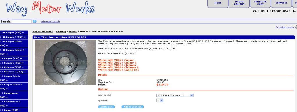

Here is where I need help. Zimmerman is $110 a set from Way
TSW slotted is $110 from Way

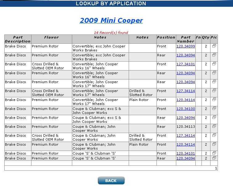

Also, I have a local MINI only shop that carries EBC and stoptech stuff and he is looking into Centric rotors, particularly the slotted only (126.34094) and the crossdrilled and slotted rotors (127.34094).
