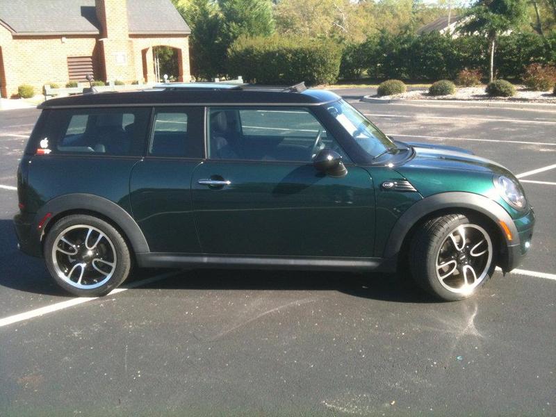

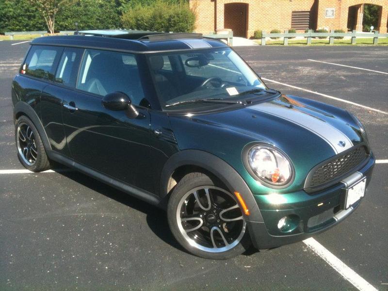

For what its worth I tried the new shoes on to make sure they fit during lunch and here are some shots

Well, I got the new tires installed on Saturday. I think they look great and they have a very nice ride. I was expecting the Cooper Zeon RS3-A's(215/45-17) to be much harsher that the stock 15" wheels/tires but I am now pleasantly surprised. The ride is very similar as before except tighter, more precise. I haven't had a chance to really test them yet but they seem to be very grippy and are very quiet.
