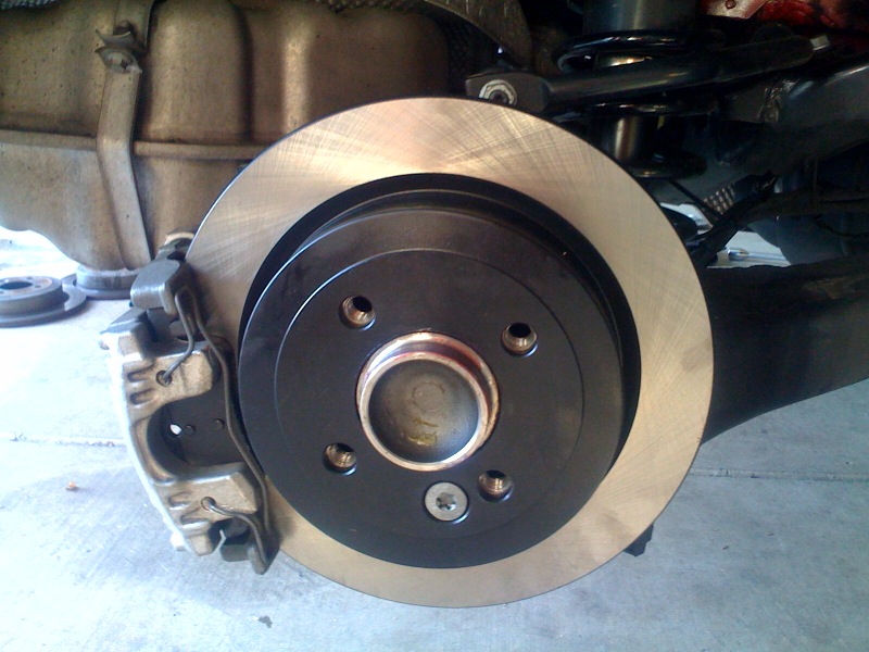

I changed the front brake pads with Axxis Ultimate pads about 10k miles ago and at 38k it was now time to do the rears. The fronts were done under the BMW/Mini maintenance plan so I only changed the pads and kept the OEM rotors. Since I'm out of warranty / maintenance now, I decided to try the Centric Rotors that Stoptech distributors like Zeckhausen Racing offer.
I've wanted to try these rotors for a while b/c
a) look awesome with the black electorstatic coated hubs and
b) are well priced and
c) are of very high quality.
Centric owns StopTech fwiw and I have no affiliation other than being a satisfied customer.
I decided to source the parts from the guys at Zeckhausen b/c have always been very helpful through the years in helping select the proper track and street pads for my RX7 and BMW.
The details of the products I bought are here:
http://zeckhausen.com/Mini/MINI_Cooper.htm
Before doing the rear brakes, on high speed (80-100 mph) stops I had been disappointed b/c the brakes didn't feel very grippy. I had used the Axxis ULT on my RX7 with great success so I couldn't understand why it wasn't as good as I remembered on that car. I was thinking of trying of trying Hawk Ceramics or HPS from Tire Rack all around when I did the rears but the Axxis Ultimates (also Ceramic material) had a higher overall temp threshold and are much cheaper so I just decided to go ahead and do the rear brakes.
I cleaned the calipers and hubs with an aluminum and brass detailing brush while I was installing everything. Then we bled the brakes. Used off the shelf Valvoline synthetic fluid since its mostly a street car. It was amazing how much air got into the FRONT brakes from doing the REAR pads and having to screw the rear piston back in.
The rear brake write-up on this site was invaluable. Thank you to the contributors! Those rear pads are a serious frickin' pita.
I bedded the brakes that same night and then did a BMW Car Control Clinic a few days later. The brakes are awesome. The car stops so much better now that we got rid of the OEM rears and they are matched the friction that the front brakes produce with the Axxis Ultimates up there also.
I'm definitely very satisfied with this brake setup
Here they are installed on my car. The cross hatching and machining of the rotors are pretty sweet looking.

Brake dust is a little less than OEM. However the dust comes off MUCH easier than the dust from OEM brake pads. A good spray of water from the hose will get most of it off the wheels and calipers then a light brushing gets the rest off. The dust from the OEM pads would just stick to the rims and was a serious biatch to clean. Even the insides of the wheels stay pretty clean. Just a spray from the hose is enough to get it off.
