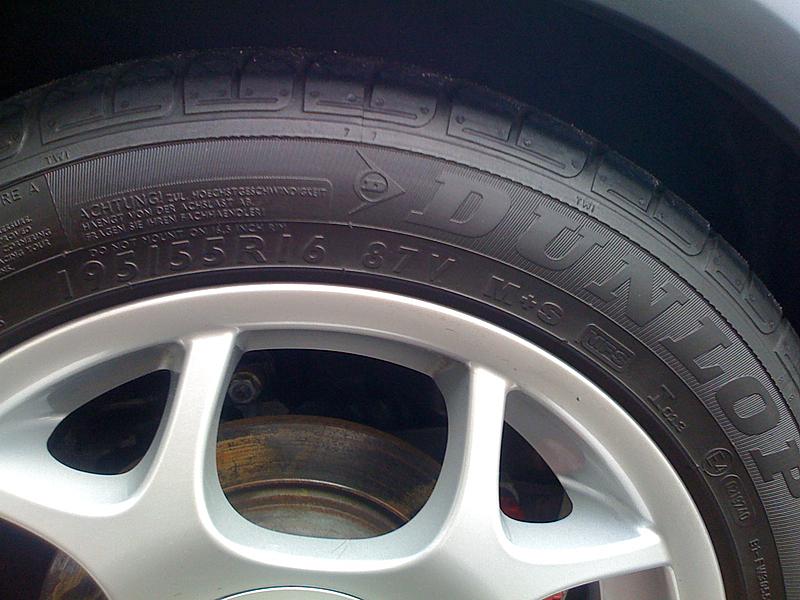

hey all, sorry abt this post but i am still confused abt the wheel on my car..
here the question:
i was told that i need snow tires when winter comes..right now its stock run flat but i am not size what size are my rims..the service advisor told me thta i need ot get the same rim size for my snow tires...the pic below show the tires on my car right now....so what do i have on my car now?
the netx post is the snow tires i found but i ahve not bought them yet as i was not sure if it will fit my car..

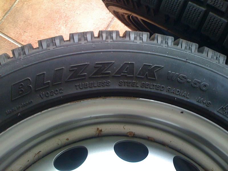

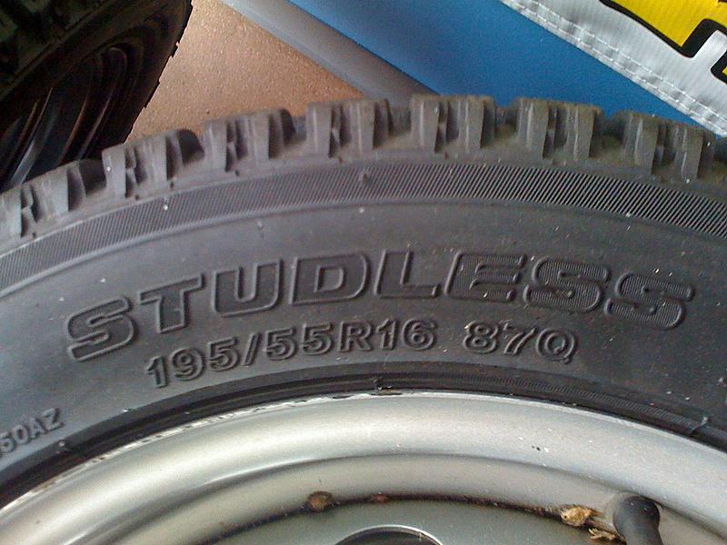

these are the snow tires that i found and will they fit on my car? i;ve not bought them yet as i was not sure....what size are these rim or tires? sorry abt these newbie question....thxs os muhc
btw, there are liek new and is $180 good price for them?

The pics show both your original tires and the snow tires to be 195/55/16,
which of course are exactly the same size..
I can't tell what the specs of the steel wheels is from the pics, though.
If the bolt pattern is 4x100, and the hub diameter is 56.1 mm, and the
offset is between 40 and 50 et, and the wheels are between 16x5.5 and 16x7, they should fit fine. This info is probably stamped on the wheels somewhere.
What car did the wheels for the snows come off of?

Your current tyres are 195/55/R16 - this means they are on a 16 inch rim.
The snow tyres you picture are also 195/55/R16 - which means they must go onto a 16 inch rim.
So, if you buy these tyres, they will fit your current rims - or, any other 16 inch rim that you choose to buy (assuming you don't buy an over wide rim).

16" steel wheels for a MINI Cooper are not very common, so if I were you,
I'd try to make sure that the hub (center hole) is the right diameter for
a MINI (56.1 mm) - same as Honda or Acura 4x100 wheels.
On the other hand, you could always get a new set of 16x6.5 alloys fairly
cheaply if the steel rims aren't compatible and put the blizzaks on them.
Also, what year and model MINI do you have? The newest hardtops use
a 14mm bolt compared to the 12mm bolt of the older models, and some
wheels don't accommodate the larger bolts.
If the wheels fit the MINI, then $180 sounds like a good deal.
If not, consider that 4 new snow tires in 195/55/16 or 205/50/16
will be about twice that price or more. How much tread is on the
Blizzaks?
