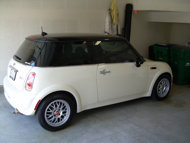

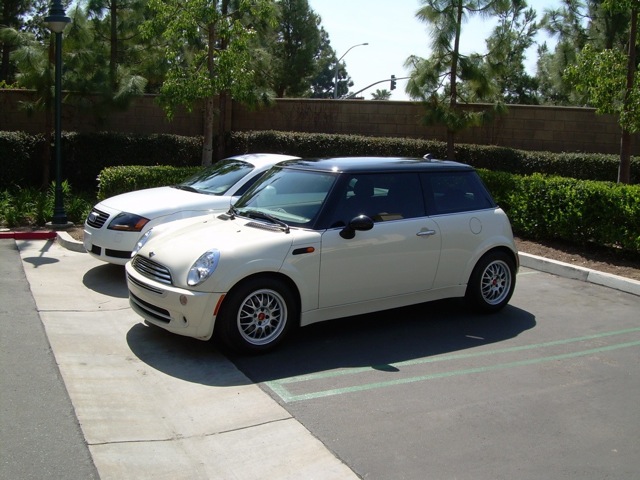

I originally had the holies & stock 175/65/15s on my '06 cooper. First I changed to 195/60/15s on the holies, and didn't like the overall "squirmy" feel in hard cornering - imo the holies are too narrow to work properly with tires much wider than the 175mm that come stock. I found a set of BBS RGF forged wheels in 15X7 which are even lighter than the holies burt substantially wider, and I'm very happy with them - nimble but with the grip advantage of more width. Couple of pix attached
If you want some high performance summer wheels & tires, but don't want to go small, then try:
Konig Feathers, 17"s are 16lbs.
Sportmax 003 - 17"s are 14 lbs.
and my personal favorite for extreme summer performance tire, Flaken Azenis RT-615.
That way, you have the larger rim, while still reaping the weight savings, for the most part.
