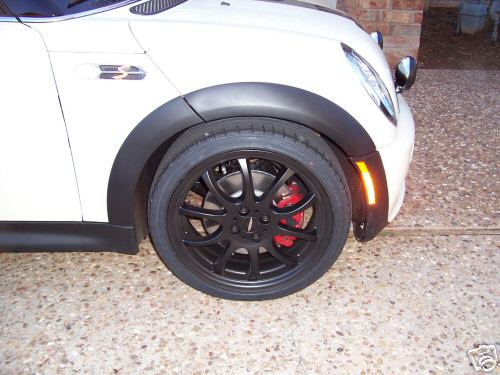

OK. Here's the car and the wheels I'm thinking of replacing.
Attached Thumbnails Options to replace 18 inch jcw wheels-mini.jpg   Options to replace 18 inch jcw wheels-6c1f_12.jpg

God I love those wheels!!!!
