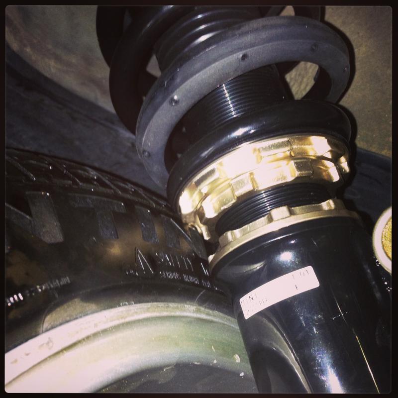

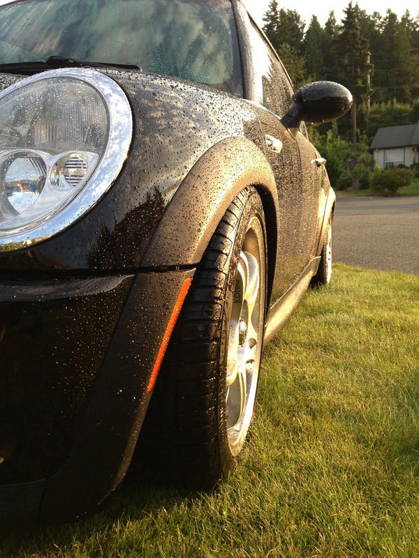

I just put some bc's in my car the other day and im trying to go as low as i can without mad neg camber or losing much handling performance. i had to get i believe a 5mm wheel spacer for the front due to my offset rims touching the lock rings to the strut. in the end im rubbing hard on my plastic trim fenders. i cut the wheel well fenders about an inch and a half and sheved the inside of the trim as much as i could, i also am almost maxed on my front camber. still rubbing. and i dont really want to raise it.
anyone else having a hard time going low without rubbing?

Looks good, but unless this isn't your daily driver, where are you going where you aren't scrapping?
Anyway, per your question, if you are maxed on camber in the front and it is rubbing then you are just going to have to raise or get different wheels. I really don't see a solution to your issue w/o running a different set of wheels or tires.. I mean you could run a smaller tread width and stretch your tires to see if that will stop the rubbing on the lower lock.

Those tires look very meaty, that's probably your biggest issue right there since it sounds like it is your tire doing all of the rubbing. As Speedracer said, try a narrower tread width or maybe a lower profile.

thank you very much for the replies. Follow up question. If i were to go with a lower profile tire... what would you recommend that is low profile but still grips well?

Unfortunately this is my daily driver. in the future i would like to purchase a rabbit or something similar as my dd and track my mini but for now i have to settle. as for the rubbing, i only rub on u-turns or breaking while turning aggressively. i really would like to get into tracking my car so all the feedback is helpful. thank you
