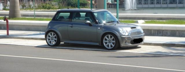

Ride height setup question for coilover suspension experts.-holidays-pictures-008.jpgThanks for all your suggestions guys, specially to Meb for a detailed explanation on this topic. My car is stock MCS and fitted with H&R coilovers, it's now lowered about an inch all round which I feel is about right. Any lower and all sorts of problems would show up (scraping front lower lip, excessive rear negative camber, harsh ride, tire rubbing...).
I tried running A and B but didn't feel too comfortable with the handling, so I ended up with about the same ride height front and rear. I've attached a small pic of my car, it's pretty stock looking but hope you like it.
The painted trim is a nice touch!
