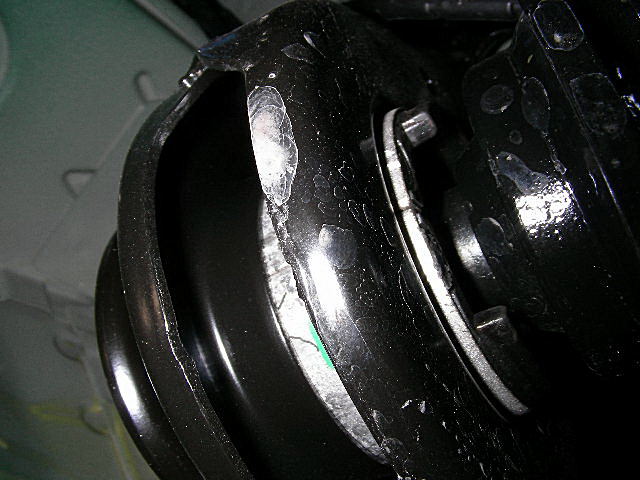

After receiving some contradictory information between PowerFlex and Mossmini as to which rear trailing arm bushing model would be correct for my 12/02 build date MINI, I did a little research. The large yellow insert PFR5-110 will fit my 12/02 2003 model build and at least up to 03/03 which is 002’s build. The smaller purple bushing PFR5-1102 is for later models; for sure on 04/06. The date at which the bracket, bushing, and trailing arm changed is still unclear. Real OEM shows a possible change on 05/03 http://www.realoem.com/bmw/showparts...81&hg=33&fg=30 . The local MINI parts counter is unable to show where the production split occurred but does show 3 different part number changes. A visit to the PowerFlex site will make you think the purple bushing is for all 03 models; be aware of your bracket type before ordering. http://www.powerflex.co.uk/products....3&submit1.y=12
Below is a picture of my 03 model bracket (dirty) and a 06 bracket (clean).
Attached Thumbnails Rear trailing arm bushing inserts installed-dscn0159.jpg   Rear trailing arm bushing inserts installed-dscn0166.jpg

Thanks for clearing that up k-huevo. I have a first production week '03, so I'll be needing the large yellow insert, PFR5-110.
Any idea/guess as to the motivation for MINI changing as they did?

I just sent you a PM. I will have the production date for the one on the right tomarrow night.

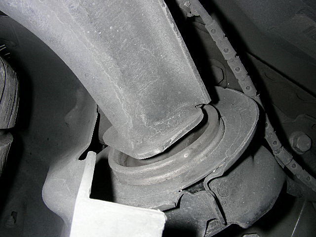

According to the Ireland Engineering web site the cutoff date was November 1, 2004 for the large bushing. While doing the re-torque at compression experiment, I discovered some small cracks in the bushing on the bolt side. I’ll be replacing the bracket before adding poly inserts.
Attached Thumbnails Rear trailing arm bushing inserts installed-dscn0171.jpg

The bolt requires a 21mm socket. I ordered the replacement brackets and Classic says March 2003 was the end for the large bushing. Don't forget to look and make sure which bracket you have before ordering.
