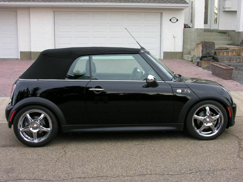

I just installed my front PSS9 and I totally forgot to measure the height of my car before doing the swap.
I have 215/45-17 tires and would like to know the height from the ground to the top of the fender so I can set it up close to stock.
Bilstein gives us 210 mm to 230 mm as an adjustment range and they are set at 210 mm from the factory, if I go to 230 mm, would that be stock height or higher? At 210, the front end is slammed right down and I'm sure if I drive it one block like that, the front fender flare will come right off.
Anyone ever found out the settings on the PSS9s, is there a way to get the car higher than stock or is the highest setting the same as stock?
My goal was to try it at about 0.5" to 0.75" lower than stock and hopefully it won't rub.

When I bought my PSS9's, I thought I could set the height to the stock configuration and the idea of having adjustable was to lower it if so desired, but it turns out the car seems to be about 1" lower with the front set to the highest setting, I wonder how this will go in the snow, it's already so low as it is, I will need wood planks just to get out of my driveway now.
So far I never had tire clearances issues but I think it will rub on turns in the front now.

Better check your install as I stated I have a good 8 turns to reach the highest setting and I still have nearly 2 finger clearance:

As for your pictures are they all with the same setting? it seems like the one on the bottom, the car sits a lot lower, as for tires, do you have the stock size, 205/45-17?
I have 215's and I turned the front nut exactly 10 turns, I marked it and counted each turn and there is only 4 threads left on top of the adjusting nut and it is a lot lower than stock compare to my pictures of before.
As for the rear, I just finished it and what I did is measured the distance as per the instructions and got it to the maximum 195 mm from the centre of the mounting bolt hole to the top of the adjusting ring and it sits as high as stock in the rear but I didn't drive it yet, so I'm sure it will settle as soon as I go over a bump.

Here's mine with the stock suspension, before the PSS9, I'll try to take new pics tomorrow.
Update: I added the "After" photo with the PSS9 set to the highest possible setting.
