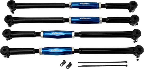

I just order myself an Alta adjustable control arms from JCS because they have the best price in town for Alta items. Save $20

Lowered my Cooper with H-Sport springs and was told alignment would be complete until I get upper and lower control arms.
At $460, the Hotchkis links aren't cheap either.

Lowering your MINI shouldn't require an alignment, however it will affect your rear camber setting. In order to adjust rear camber, you will need adjustable lower rear control arms. You won't need to replace the uppers.

3) Rear camber is pretty severe. Looked out for some used H-Sport control arms. Found a pair and bought them. Just got them on, and will get an allignment (grrr, after this weekends track time!)

Just got my MCS alignment done today with Alta adjustable control arms and the rear tires vibration is now gone.
At the same time I also got the Front align with out any adjustable control arms added
The MCS so now run so sweettttttttttttttt Thank you all help... NAM are the best
