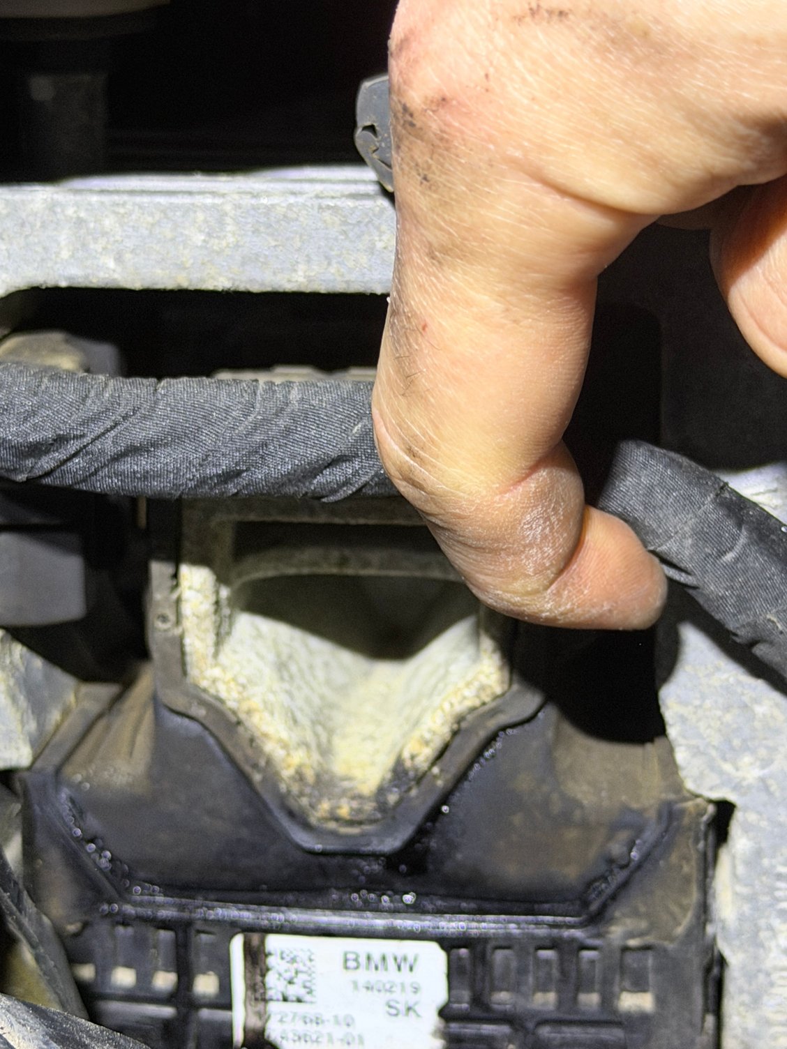

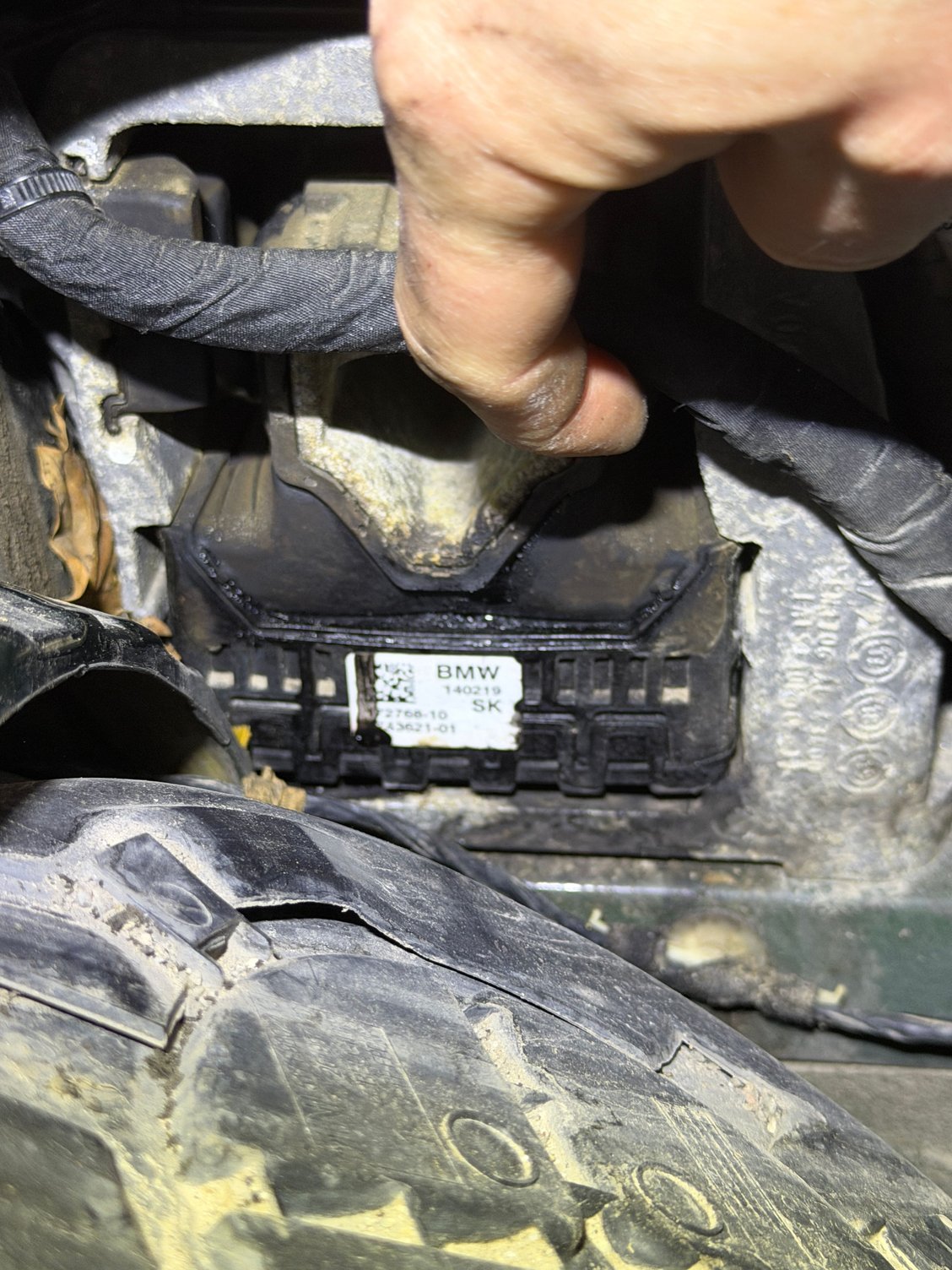

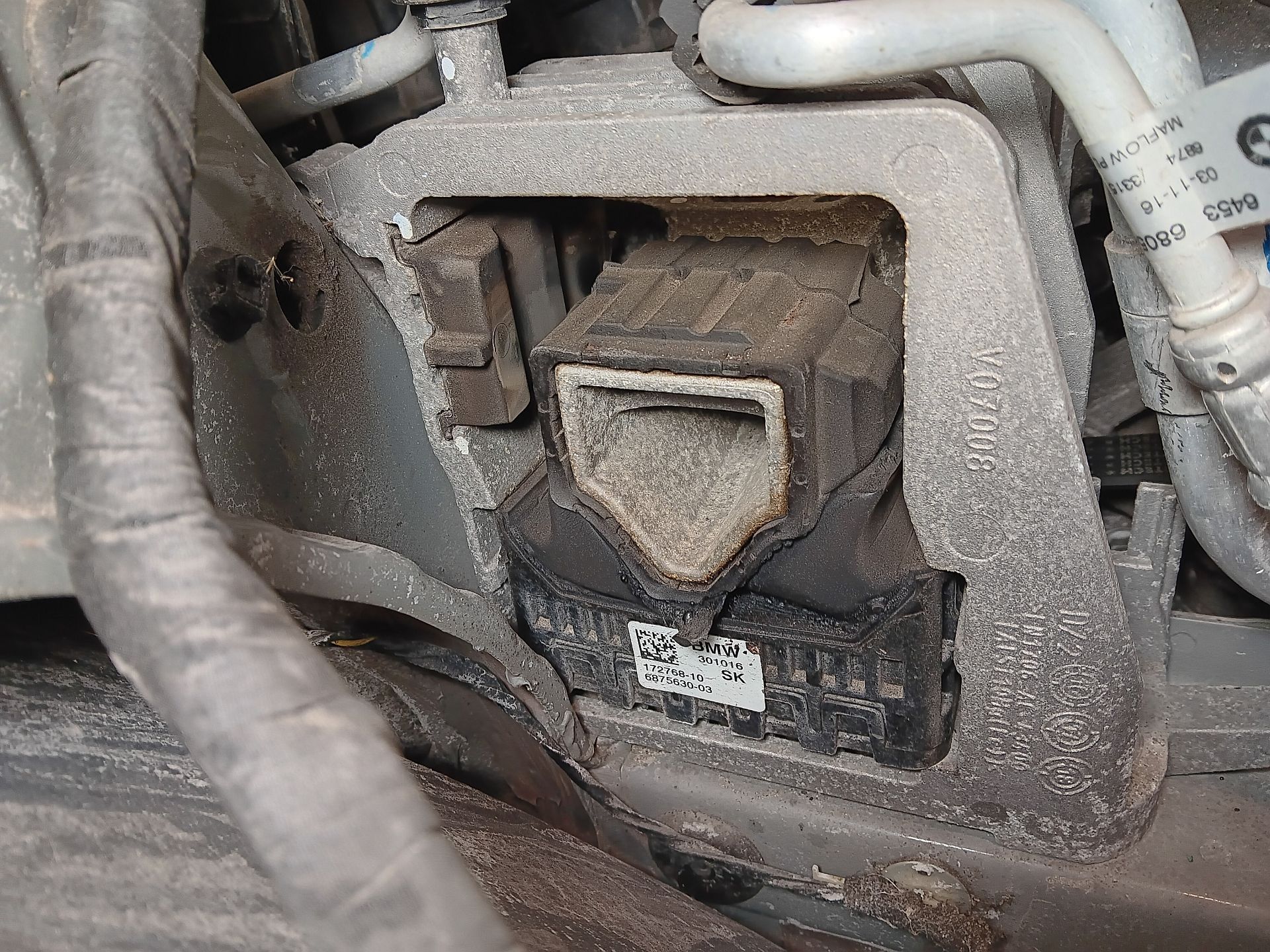

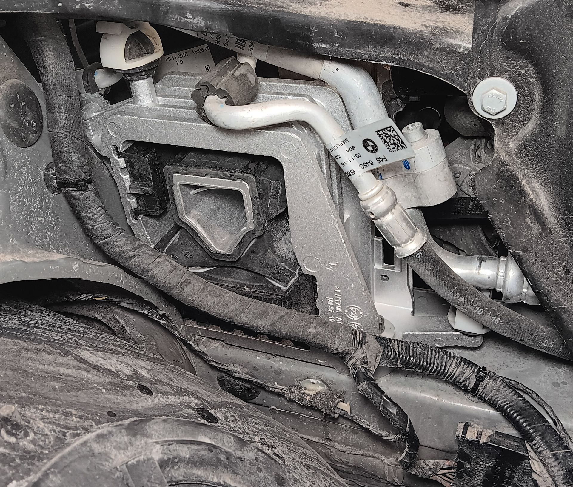

Well, if you are certain on your alignment and the suspension is in good condition, your engine mount is just one of the more likely sources of a vibration like that. The upper passenger side mount is a liquid filled mount and WILL eventually leak. Sometimes you can see the staining of the fluid on the mount, but really the telltale way is how low is the mount sitting in the housing. Below are before and after pics of my mount and the difference is pretty noticeable. The new mount in my car got rid of vibrations at certain RPMs as the engine works it way through its own harmonics.

Thanks for the information, but if the engine mount were truly faulty, the vibration would be in the front axle. Currently, the vibration is coming from the driver's side axle shaft. My question is, if the vibration is on the driver's side, it's unlikely the engine mount on the opposite side would be faulty. I'm definitely going to check it anyway. Thank you so much for your help; I'll keep you updated on the mount issue.

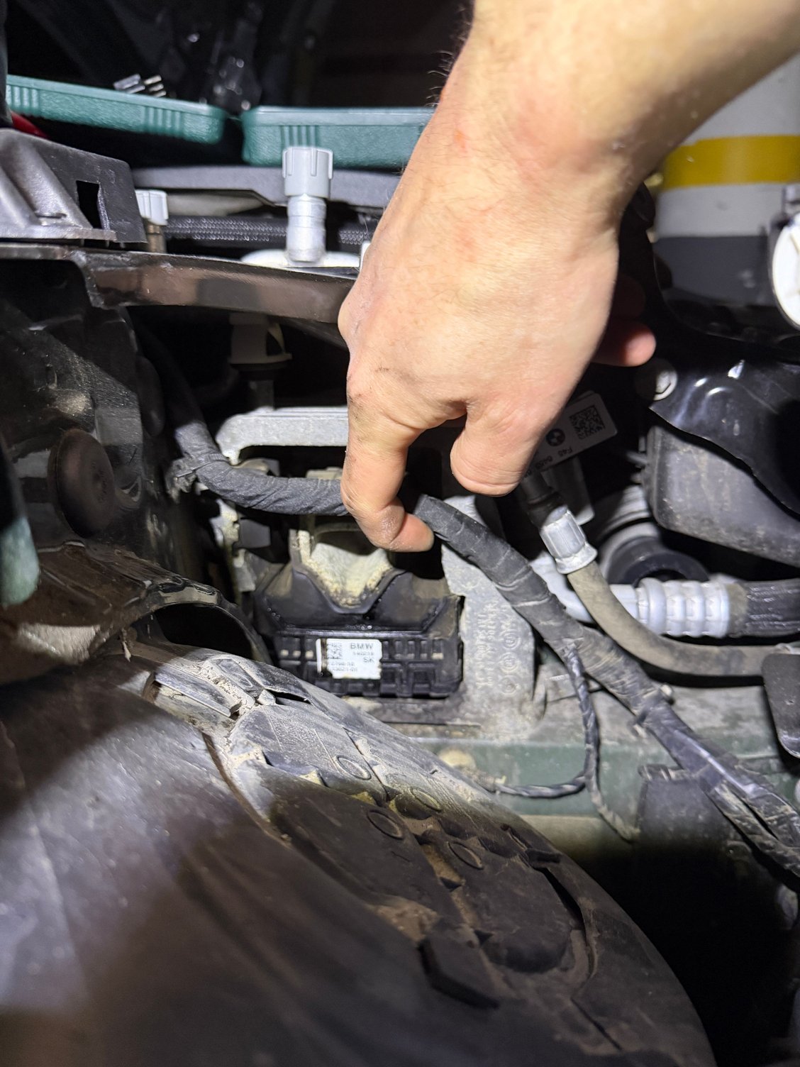

[QUOTE=hITO7818;4709363]Thanks for the information, but if the engine mount were truly faulty, the vibration would be in the front axle. Currently, the vibration is coming from the driver's side axle shaft. My question is, if the vibration is on the driver's side, it's unlikely the engine mount on the opposite side would be faulty. I'm definitely going to check it anyway. Thank you so much for your help; I'll keep you updated on the mount issue.[/QUOTE
Well, I thought it might indeed be the engine mount; I checked and it's completely destroyed.

Yep, that mount has leaked out its fluid, you can see the marks from the fluid. That would allow your engine to tip down on the passenger side, which changes the angle of the output end of the trans and will load your CV joints differently than stock. It could certainly be the cause of your driver's side axle.
