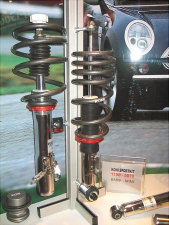

I took some pix at Koni's booth from Essen...
Attached Thumbnails KONI Coilovers IN STOCK!-f5fc155b.jpg   KONI Coilovers IN STOCK!-f5fc0ff0.jpg   KONI Coilovers IN STOCK!-f5fc0e82.jpg

OK I'm back,
Height adjustment - about 0.5 to 1.5" lower than stock.
Adjustments - **** from top in the fronts, fully compress & turn in the rear.
Spring rates - not published. KONI says Progressive springs are optimized for these dampers, providing better ride quality (at the softest setting) than stock while improving handling performance.
This KONI setup is for the street, with available adjustments for those looking for a 'sportier ride'. If you take long drives, have a spouse &/or little ones, live in a area where the roads aren't the best, AND you still want your MINI to handle better than stock - this kit is for you.
Let me know if you have further questions.
Ken
What is that?
Old Jan 25, 2005 | 04:27 PM
kenatminimania's Avatar
kenatminimania
Joined: Sep 2002
Posts: 446
From: Nevada City, CA
This is a common method of adjustment for shocks in the european market. Since this coilover system is targeted for the street MINI, it is anticipated that the owner will rarely changing the settings once set at the desired level, unlike a track MINI. However for those who wish to experiment, removing the rear shocks is not difficult.
By fully compressing the shock, the mechanism for adjustment is engaged. Starting from a fully 'soft' position (full counter-clockwise), you turn the shock body clockwise the desired amount to stiffen the rebound. Once set, you can release the shock back to full extension.
Hope this helps.
Ken
