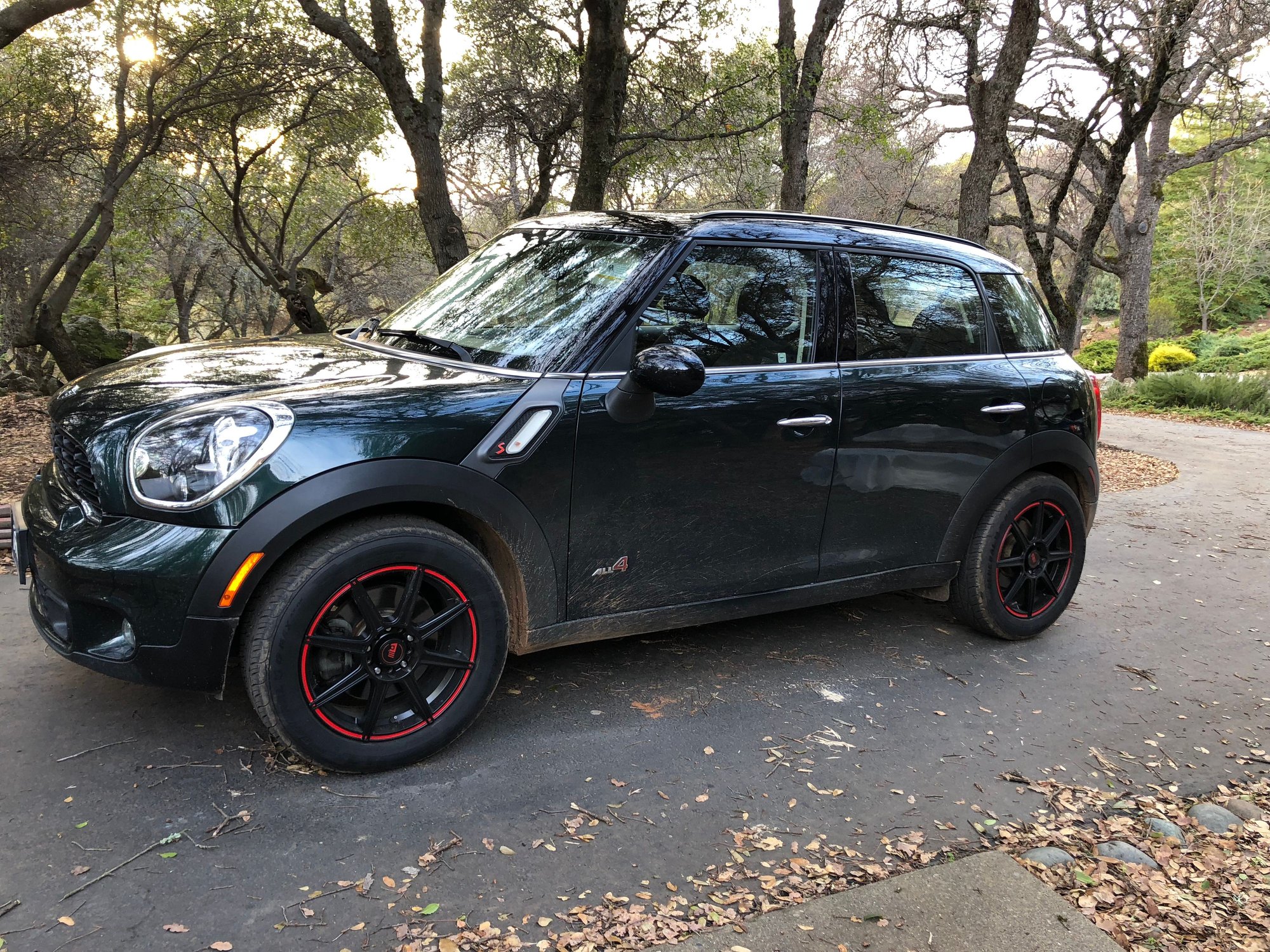

Way, thanks for the input on the B4s. I just put those 17" wheels with the GMax-05 225/55/17's on (in the picture below). Now it really does the boat pitch and yaw. Like now its scary to drive compared to the 18" turbofans and the 225/45/18 Summer Efficient Grips ROF. It was just annoying heavy (lumpy hard kinda thing) then with a good amount of sway. NOW its scary! Today I went over the railroad tracks and the car was doing the tail bounce for several feet after. In the twisty turns of the mountains it is scary...not fun to drive, feels like it is leaning to flip and the tires losing grip..was wondering if that amount of sway was due to the 55/17 tire combination (why would anyone put on 17s and 55 tires with that kinda deflection, yet its all over this forum?) so it can't be the tires...can it?... are the General Gmax-05 that soft on the sidewall? or is it the combination of taller tires, BAD SHOCKS and NEED NEW SWAY BAR. I feel like the ROF were doing better in the handling dept (except a little heavy and hard) or if the shocks now are just showing to be worse than before. I also got out and bounced on the door sill and the car was acting squishy. About ready to put the 225/45/18 ROF back on.

Its scary around the twistys! and I kinda need the bigger tires because of going on dirt roads frequently. I really like the 17" motegis.
