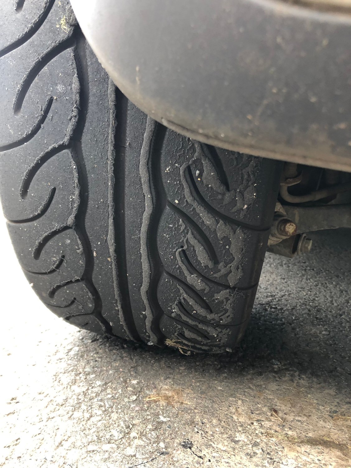

Just thinking out loud as I’m due a suspension set-up at the end of this week, with a track day next Monday
how much will using older worn rear tyres impact the final result?
I think the weight will have marginal effect, but 1/4” of tread depth might on ride heights and corner balance,
how much will 1/4” of thread on a coil over change overall weight balance, or should I ask for 1/4 plywood under the rear wheels ?
the rear ado8r have enough life for a good track day, I don’t want make them off for the sake of the geo, equally i don’t want another setup session for new rubber, I might also be overthinking all this as it’s static thing across the same axel, dynamic loads and bends will change everything anyway ?
Spec - bilstien pss10/16, 26/20mm arb front and rear, Adjustable drop links all SuperPro, Gp2 free camber, 2 degrees caster bushes, giken clutch, quaife diff, 215/45/17 on et37 oz
i have rear arms to fit if needed,
handles very well at the moment so not expecting any night and day improvements, but I might be surprised.
these are how the rears looked 18 months ago after a morning at Rockingham, after some provocation
just above wear bars now, to be replaced this summer with A052 215/45/17 all around
I should add that currently I have decided not add camber plates, as the car is mostly a summer Sunday afternoon street car, and the Gp2 strut-top slots are ok for now, I like the sleeper look even under the hood,

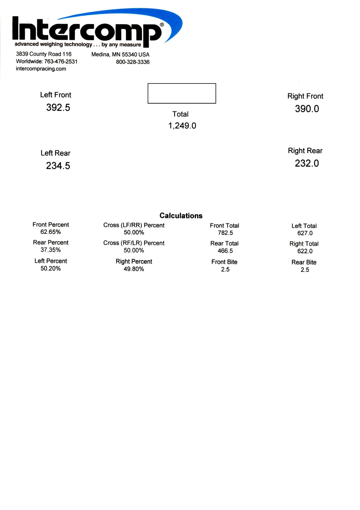

Just done today, 1249kg with just over 1/2 tank of fuel, on track Monday with forecast showing sunshine all day
cross weight within a kg or so, will report back what I find on the track
FYI for anyone considering the gp2 strut-tower slots, this “free-camber” gave me some very interesting front toe numbers when combined with caster bushes and lowering
please book or check your alignment after, as I am sure it cost me more than a few thousand miles on additional tyre tread last summer, compared to the mileage I was getting on Ad08r from my more powerful r53 a few years back
so yes to opening post, everything is worth looking at again after a fresh install, the law of unintended consequences will bite your butt otherwise.

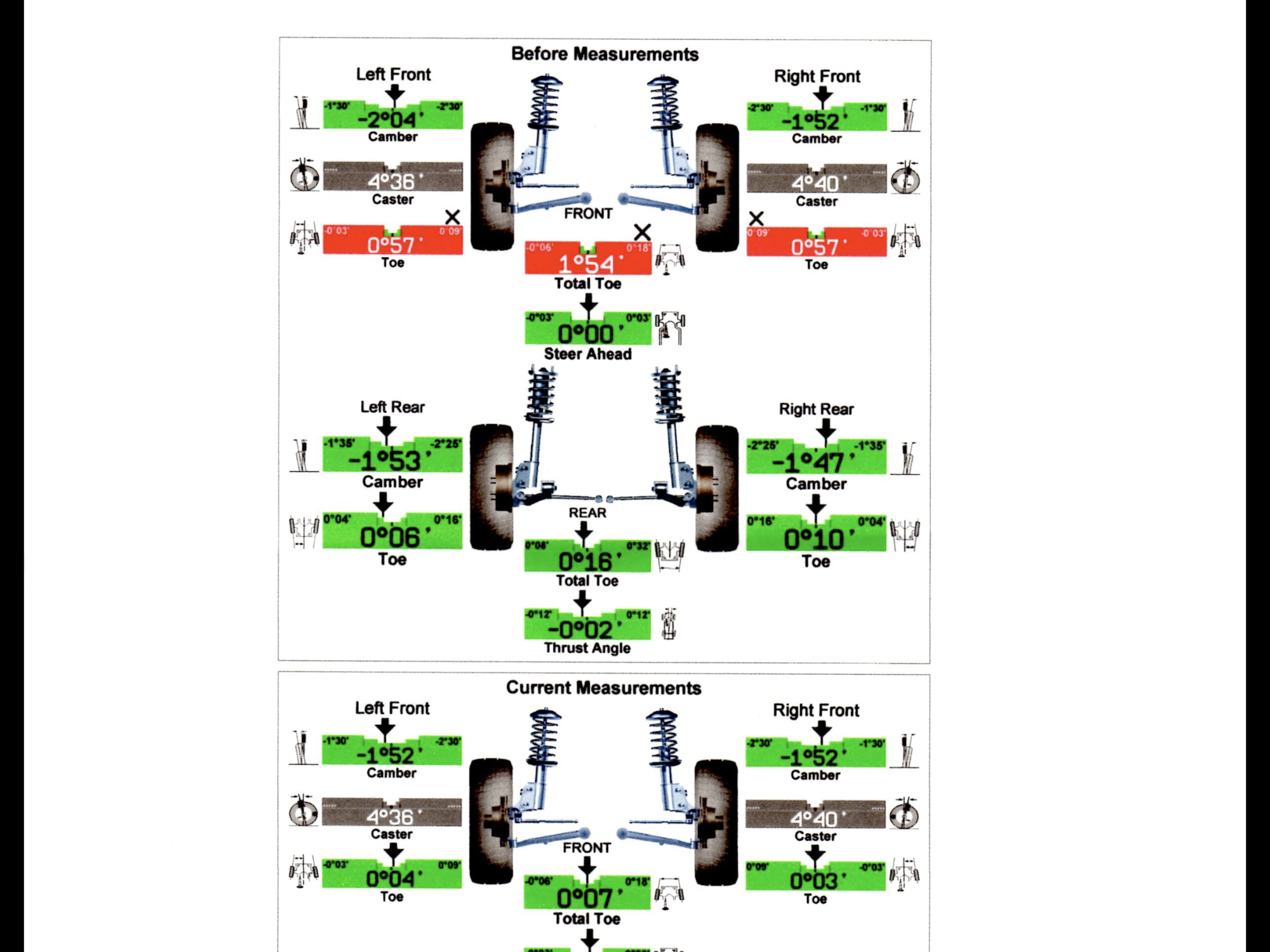

Of course any camber change will affect toe significantly and require alignment thereafter. Remember a single angle minute doesn't matter for camber and caster, but it does for toe. I did notice this fact is missing in many 'free camber mod' discussions. It's free if you do your own alignment. I still recommend adding front camber though.
Old Apr 6, 2021 | 09:14 PM
blue al's Avatar
blue al
Joined: Aug 2007
Posts: 618
Likes: 61
From: Oxford England
removed some rear rake, and some toe, note the caster is improved via superpro front wishbone rear bush (spf 4476-80k ) to help the dynamic camber.
on track I actually felt I missed some toe on the tight hair pin corners, but I’m sure my tyres will thank me longer term.

Originally Posted by blue al
Are these numbers after performing a corner balance? They look pretty good.
yes but they weren’t too far out from original installation, I had the B16 coilovers second hand, and used a good shop for the initial install, along with lsd and roll bars
I had driven nearly 10k and several track days, it was after my own free camber modifications and adding the gp2/135i calipers that I thought it would be a good time to check the car out properly on the scales.

I Am impressed that the Mini is that close to balanced out the box.
