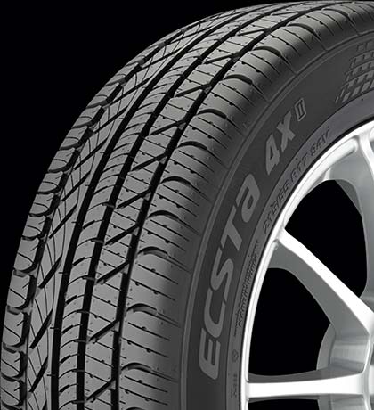

For Tires...I've looked around in the 16" sizes... and all are within 1lb of the factory size of 205/45R/15... in the same NON-RF tires.
Not sure if there is much to be gained in terms of weight loss here... but a pound is a pound !
The one that sticks out as a great tire for me... is the Kumho ECSTA 4X II in a UHP-AS tire... which is what I'd want.
The ECSTA 4X II - 195/55ZR16 is 19lbs
The ECSTA 4X II - 205/50ZR16 comes in at 21lbs
For comparison, the OEM size - 205/45ZR17 ECSTA 4X II - is 20 lbs.
... in the Goodyear Run flat 205/45ZR17, it comes in at 22lbs.
So... with the Kumho ECSTA 4X II 195/55ZR16 ... I only drop 1 lb... but I prefer the ride of this tire to to the stock tire measure.
This still brings the weight savings on to 7.5 lbs per wheel.
The Kumho ECSTA 4X II comes in, for me, as a solid price/performance value.

I've ridden in another with the POTENZA RE-71R 195/55/16 ... it certainly didnt lack grip
Also the ECSTA 4X II in the 195/55/15 grip super well too.
I've ridden on winter tires in the same size... not a stellar road character or road handling..
