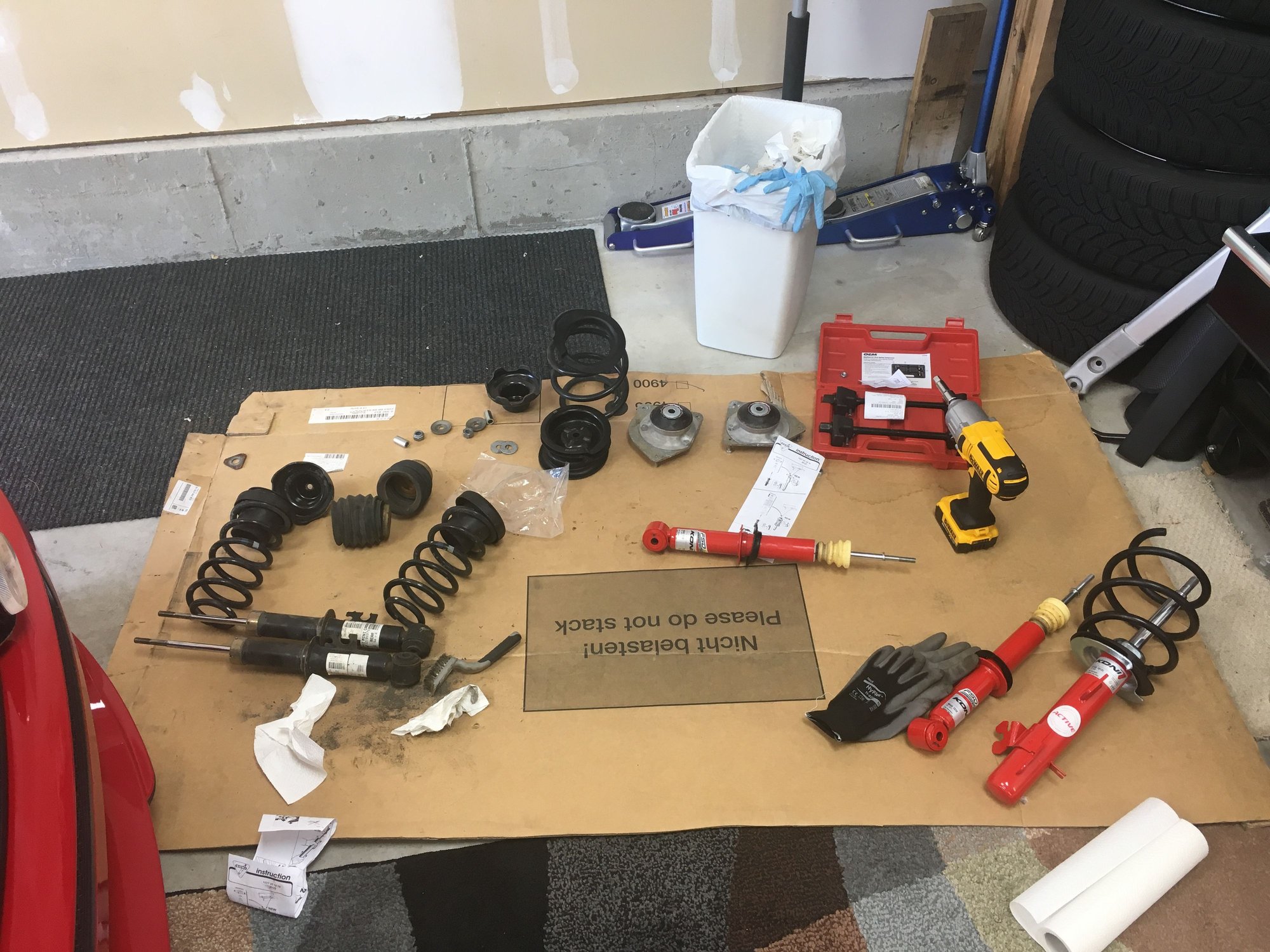

Welp my order arrived yesterday, openend the box and they are the red special actives, so it looks like they are starting to ship! That was a nice surprise. I got them on today, and they feel pretty good, complaint and soft but little body roll. Turn in and corner stability is not as good as the megans though, even though I went back to my ie -1deg camber plates and went to full hard on my 25mm rear bar.
The wife prefers these.. My megans are up for sale!

Yes, like the FSD, you are supposed to retain stock ride height. I am using the stock R52 jcw springs. You need to go to yellows to go lower.

Just put the Special Actives on and man, what an improvement over a sport suspension with 50K mi.. Tossing the runflats was also a great mod, for me at least,
