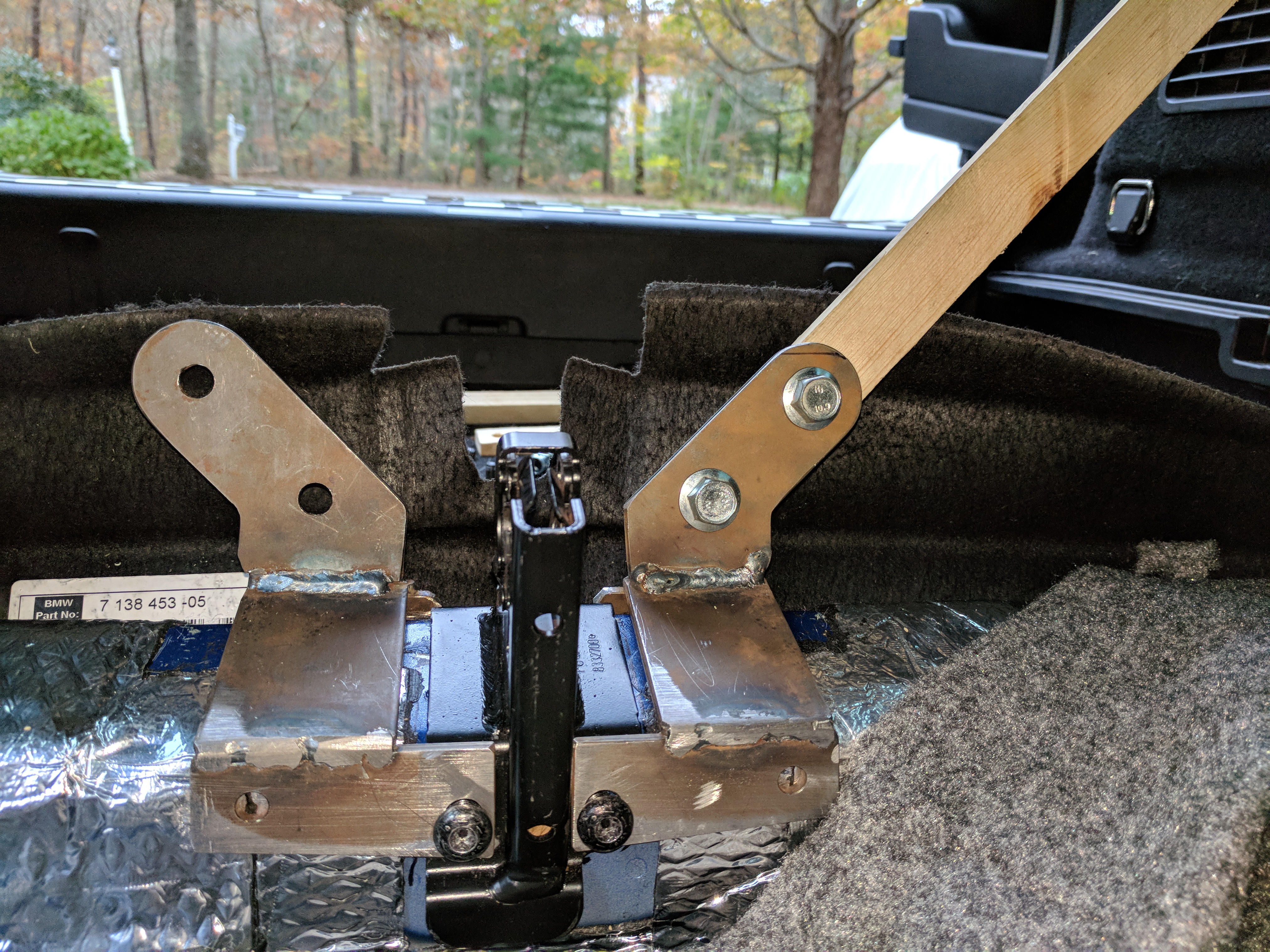

Got any photos of how the bracket at the bottom of the seats installs?

Striker Plate Pictures
I leave the plate in place....it pushes the top of the back seats forward about half an inch...

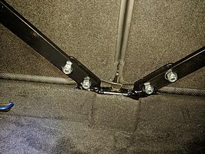

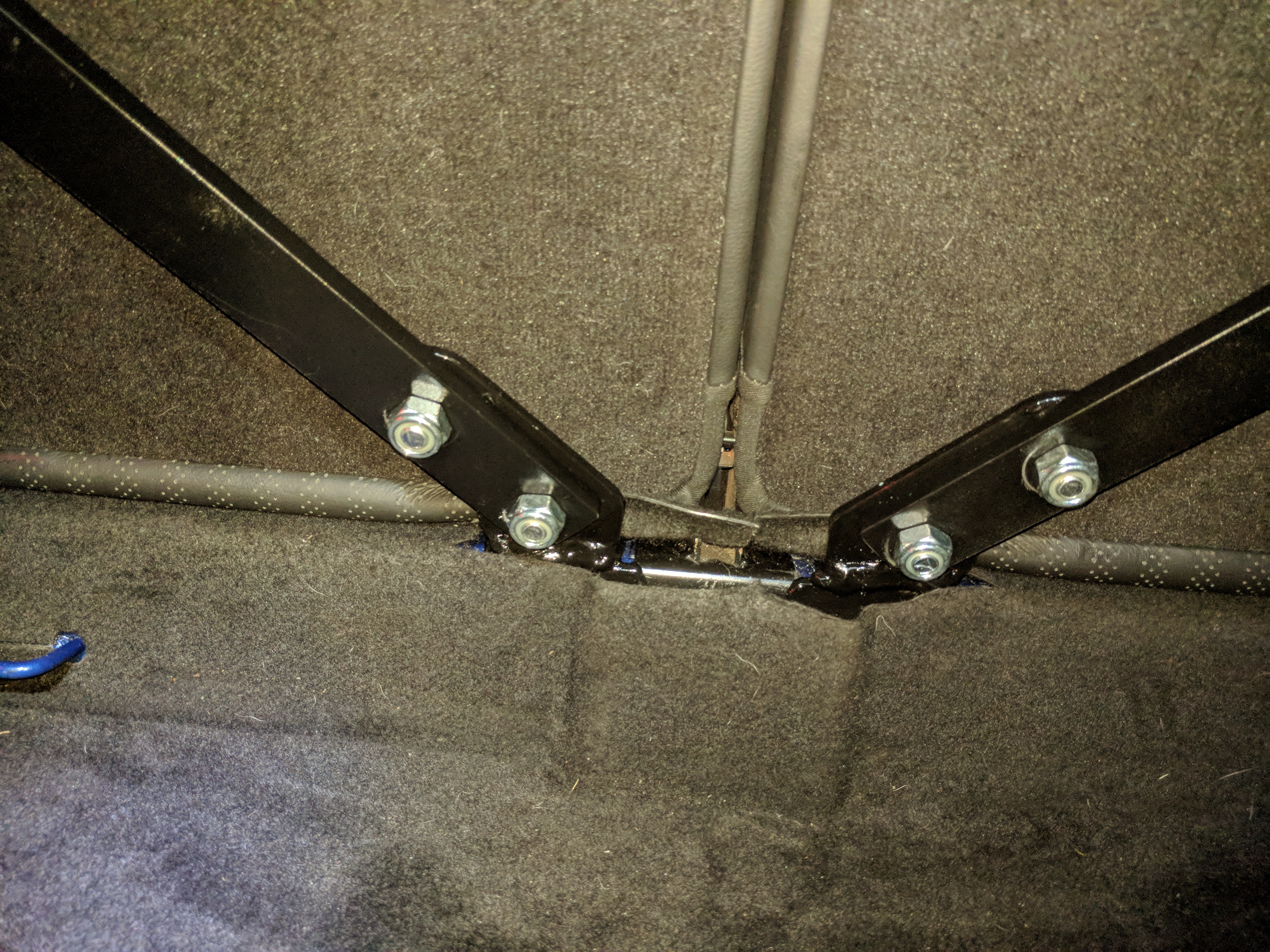

Lower Center V Bracket
I have two pictures of the center bracket. The picture taken from the front to the back of the car was taken during the design phase, so the bracket was not finished. The picture taken from the rear to the front of the car doesn't show the two mounting bolts - they are covered by carpet.
Attached Thumbnails R56 rear seat upper striker latch-img_20171106_150808.jpg   R56 rear seat upper striker latch-img_20171116_152233.jpg
How much extra stiffness do you think the lower braces add, over just having the cross bar behind the seats. I’d like to not lose too much cargo functionality, if possible.

That's really hard for me to tell.....I installed the entire brace assembly (cross bar and V bars) just before the last autocross of the 2017 season, and I could tell a difference. I'd guess that you'd get a significant gain in stiffness with just the cross bar.
I can tell you that pulling the unit out, but leaving the upper plates in place and the lower V bracket in place takes about ten minutes. The lower bracket sticks up a little when the back seats are lowered, but I just covered it with a plastic parts storage bin, which works well for me. Removing the lower V bracket requires removing the rear seats, which, as you know, isn't tough, but it takes more time.
In the long run I'm going to delete my rear seats, so removing the lower V bracket will be quick....which I'll probably do, depending on what I'm hauling. If I make or buy a rear seat delete kit, I can incorporate some sort of cover for the V bracket.
