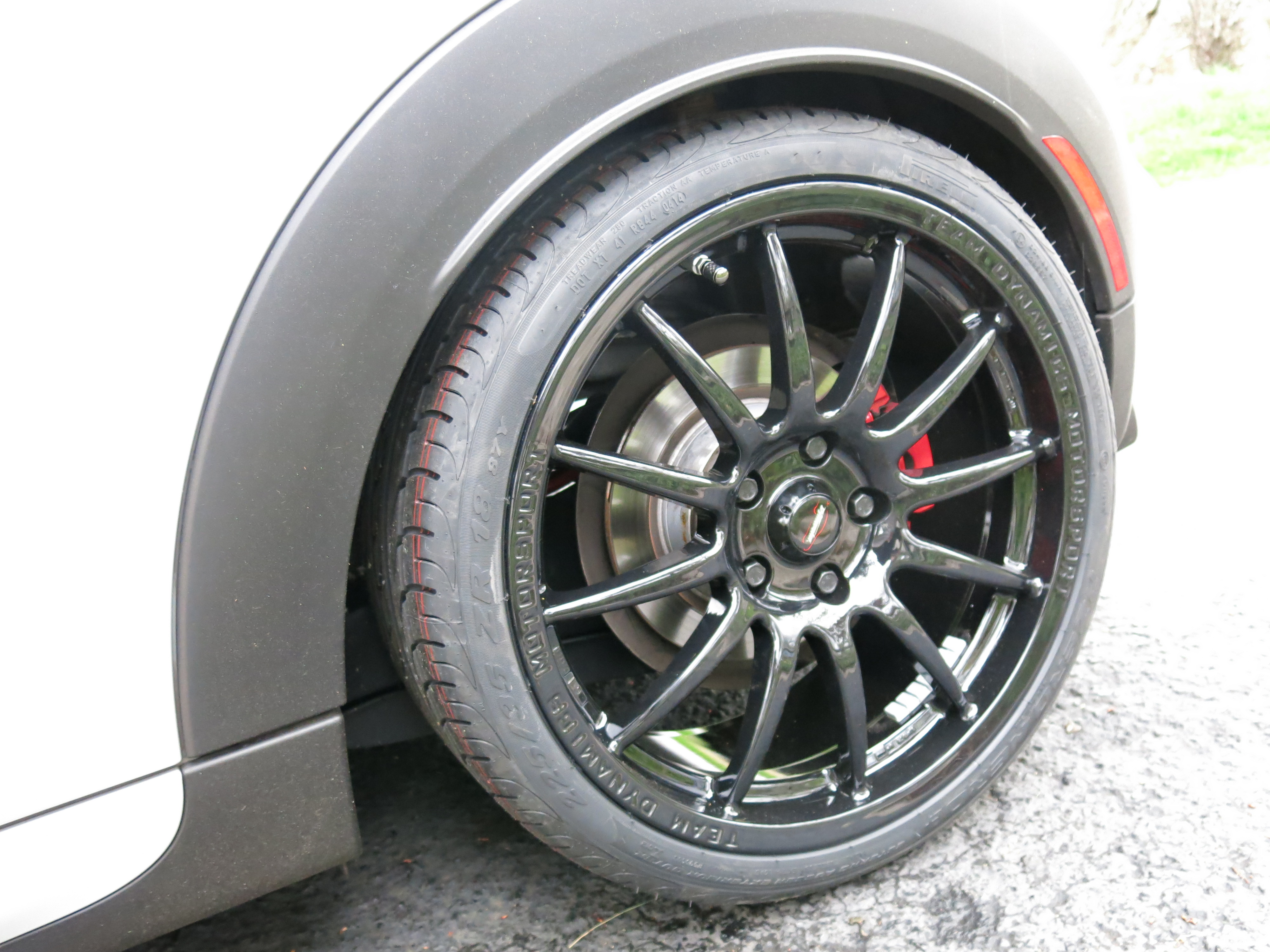

I recently got a set of Team Dynamics ProRace 1.2 in 18x8 +40 from outmotoring.
I am running 225/40/18 Bridgestone Potenza Re-71R in 225/40/18.
My suspension set up is as follows:
KW Variant 2 Inox
Megan Racing adjustable upper and lower rear control arms
NM Engineering 25 mm rear sway bar and endlinks
Powerflex Front control arm bushings with camber adjustment
My alignment settings are as follows:
-1.5* camber, 0 toe up front
-2.5* camber, 0.2 toe out rear
There is a little rub (I am LOW and the Re-71R's run wide. My 225 is closer to a 235/240) but the fenders are self correcting as we speak .
For those who are a little more conservative or not running the lower control arm bushings for the additional camber - I think that a +45 up front and 215 max would be ideal. For those that freak out when they rub a little or have to remove little rubber nubs as everything settles you definitely will not want this.

Any side or rear pictures? Nice to know 225 40 18 is possible with 18x8 tires.
Old Mar 27, 2016 | 08:54 AM
VolcanicOrangeF56S's Avatar
VolcanicOrangeF56S
Joined: Mar 2016
Posts: 61
Here you go!

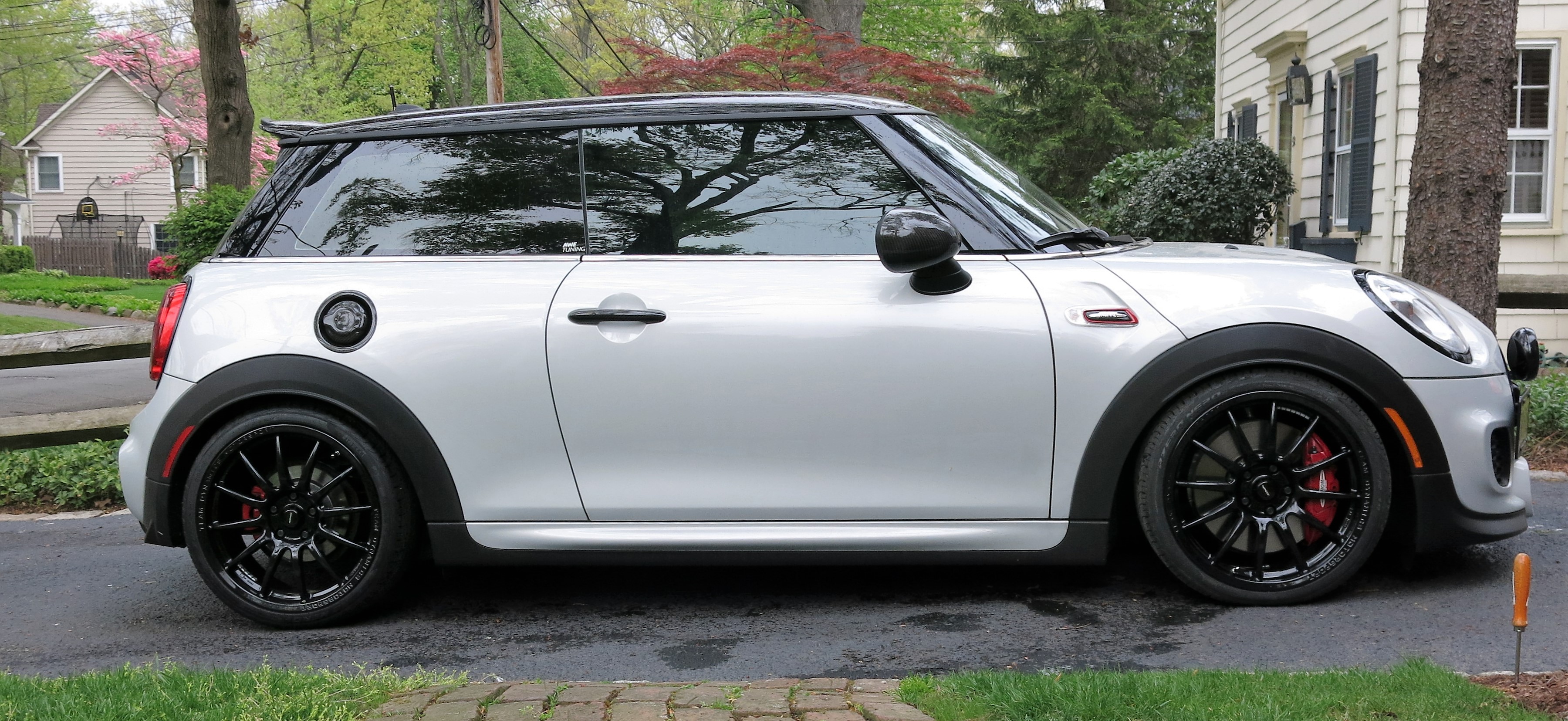

RDSJCW's Avatar
RDSJCW
Joined: Aug 2015
Posts: 405
225-35-18's are fine on 18x8 wheel.
No rub/no poke even with coilover susp/ lowered.
Attached Thumbnails Team Dynamics ProRace 1.2 18x8 +40-img_3213.jpg   Team Dynamics ProRace 1.2 18x8 +40-img_3207.jpg   Team Dynamics ProRace 1.2 18x8 +40-img_3206.jpg

Not a lot of tire options in that size though �� Once camber plates are available I think this set up will be the way to go for aggressive fitment and big tires for more folks. For now it works great for me you just can't be shy while it rubs itself out some room haha

RDSJCW's Avatar
RDSJCW
Joined: Aug 2015
Posts: 405
Agreed. It wont work. Cancel ur wheel order.
e45 in 18x8 is the only correct offset that leaves a few Millimeter clearance of the caliper s & struts.
It allows 225-35-18 tire fitment with lowered vehicles. No spacers needed.
