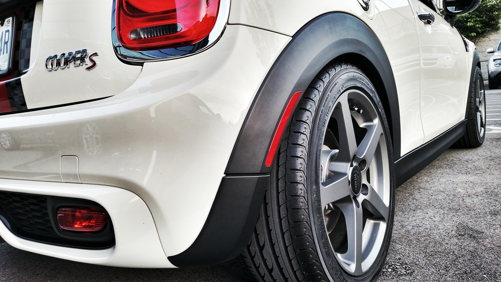

I have both the NM springs and sway. HUGE improvement to both handling and looks. Highly recommend both.

Hi JamesDean
nice looking wheels man!
Do you have adaptive dampers? - just looking at the wires around your shock absorber.
And what springs did you put in, are they lower?
Im about 2 weeks away from my new Cooper, with adaptive dampers, but not sports suspension, so wondering about the sway bar option.
cheers

Yes mines lowered on NM springs. Did not go with the dampers since you can not lower the car with them. I am sure you can still do the sway all though it might make it more of a pain in the ***.
