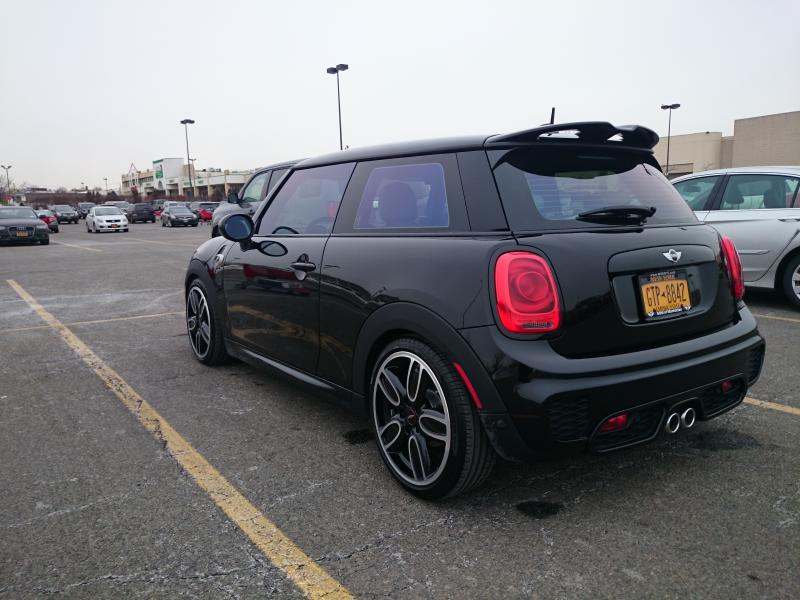

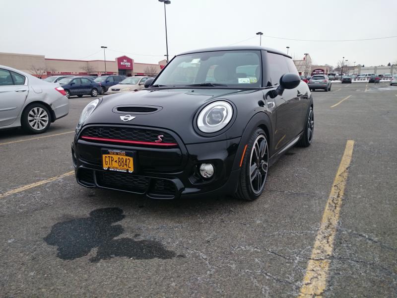

My car already had factory fitted sports suspension and I've just replaced the OEM springs with Eibach springs. I was a little worried about how the ride might be now the car is lower but I'm very happy to say that the ride feels better - not quite as harsh as the std sport springs.

looks like the rear sits just a bit higher than the front. is that accurate?

I think it might be just a touch higher as it's still settling after installation. Plus there was almost nothing in the car/fuel tank

Spacers? If so, what size/brand?

H&R 12mm at the front and H&R 15mm at the rear (also bought longer bolts)

Do you still have room to go wider if you wanted, or are you at the limit now with the drop?
Any rubbing?
One last question (appreciate your time).....did you stagger the front and rear so they would both be at the same point on a plane, or do the rears stick out further than the fronts? (Hard to tell from your pictures).

I'm not sure about wider - I'm pretty happy with how it looks and so far no rubbing at all. I chose the mm based on what I had seen on a German forum as it seems to fill the arches quite well.
