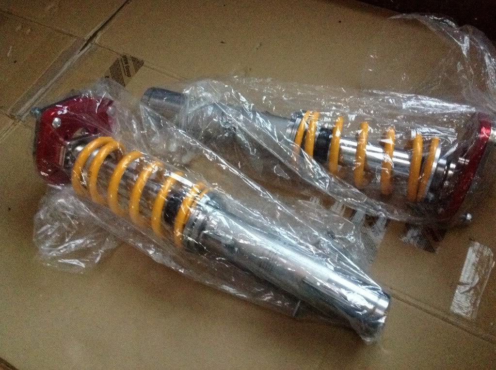

You ended up getting the same as me. Got my Ohlins and Vorshlag's in three days from ordering. Installing this weekend.

Install is pretty simple if you ever did lowering springs. It's not much different. You reuse the top hats from your stock shocks for the rears and since you have camber plates the front are just a straight replacement. Setting the car up after the install is where the magic happens. If not doing it yourself, I'd recommend a mini shop or local race shop that deals with German cars.
