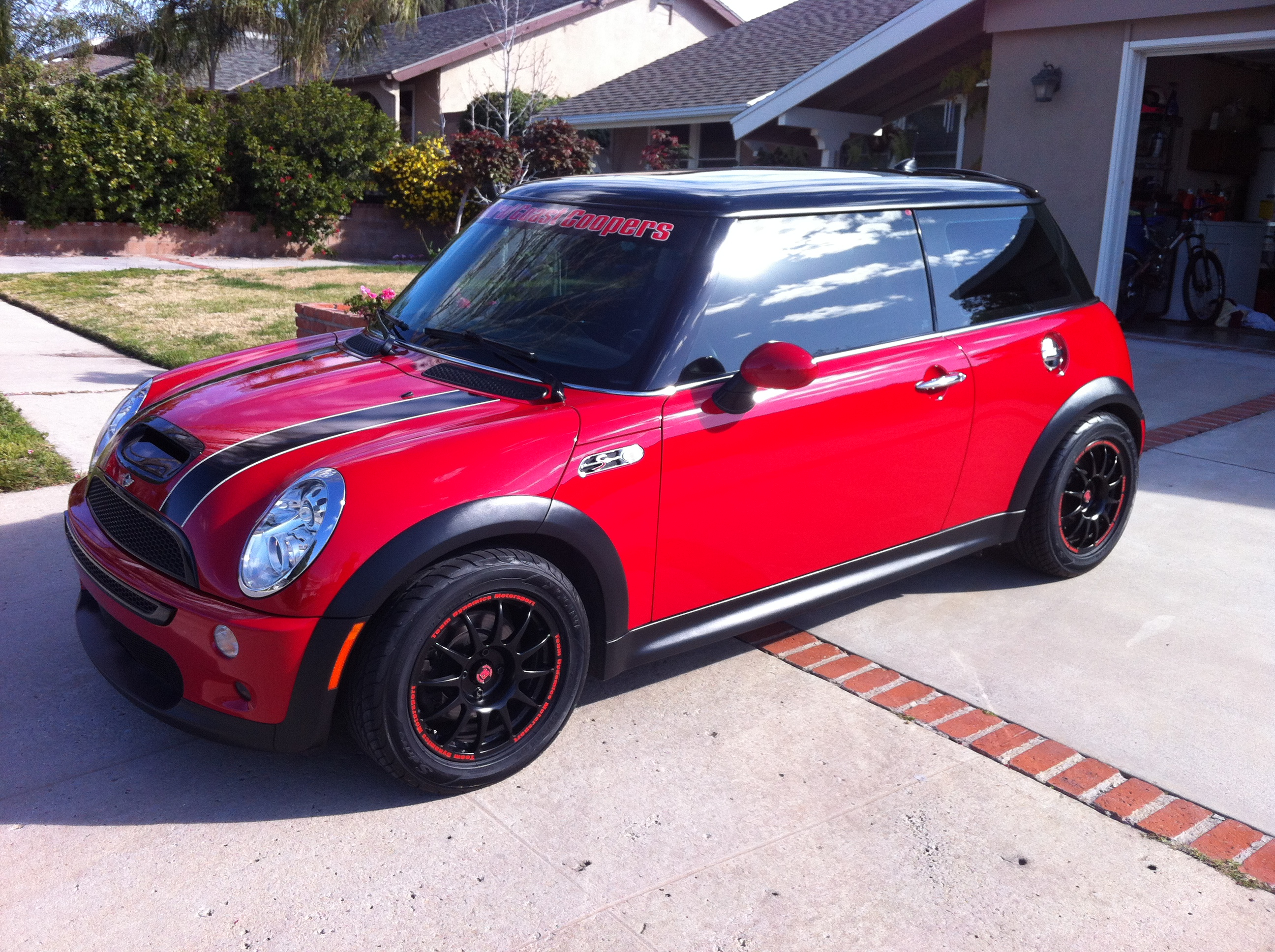

So, here's where I'm at: I have an '05 S with about 82,000 miles on it. I've noticed that the ride is getting pretty harsh, so I know my struts are shot. There's no wallowing, but the ride has gotten worse over the miles. I'm now hearing a loud squeaking sound out of the right strut tower when I go around corners. I looked at the top mounts and both are broken in the front. If I put my hand on the body where the struts are bolted to and someone turns the wheel, I can feel the vibration from the squeaking. I figure, I might as well spend a little extra and get Megans or BCs, as apposed to replacing all 4 struts and top mounts. I have always wanted to do that anyway. I have some questions:
1. If I'm only going to lower 1" and I want to be conservative on the camber, it's my daily driver, can I wait and get adjustable rear arms in the future?
2. With the above parameters, will I have to do any trimming to the front mounting holes in order to properly tighten things up?
3. I really want adjustability in the rear. Is drilling for adjustment cables a bad idea in any way? I Also have the OEM amp back there.
3.5 Do the adjustment cables have to stick up through the interior, or can I keep them short and access them through the little doors on each side?
4. Are there any other parts or anything else I need to know. Money is a little tight right now, so I want to do it as cheaply as I can.
5. I'm running 205x55x15s with 40 offset wheels, will I need any spacers in the front wheels?
Thanks for all your help,
Shawn
