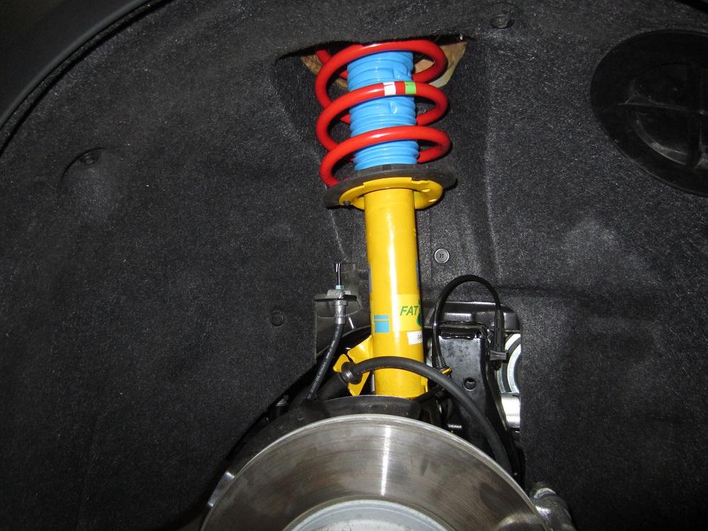

i guess i'm still confused. what dampers/boots are you referring to?
here are a few shots of my suspension, dust boot covering:
Old Apr 29, 2014 | 09:19 AM
LarriB's Avatar
LarriB
Joined: Dec 2009
Posts: 299
Thanks Mini2NA. I'm glad to hear that running without a boot is okay. Kyoo - I'm referring to the blue boot in your picture. The original boot is black rubber. Apparently the front boot is too big and stiff to fit around the new smaller diameter Fat Cat bumpstops tightly, even with zip ties. Perhaps if my installer was more than a 2 man shop who did a lot of aftermarket work, he would have had a boot with a smaller diameter to fit the smaller bumpstop.
