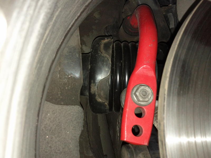

Here's what they look like under load. (I post the pic and risk indicting myself for not keeping my MINI spotless)
Attached Thumbnails Swift Springs Spec R for the R56 is out!-img_20120314_202345.jpg
