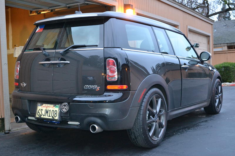

I have a 2011 Mini Cooper Clubman, I just want to lower it, no plans to race it, what's the best springs around? where do I take it (shop) to do it? I have a 17" Borbet LV4, Bridgetone 215/45/17 XL tires, NM stress bar, what would be the issues tLets have your opinion on lowering springs!-dsc_7158.jpg
Lets have your opinion on lowering springs!-2012-03-02_20-30-15_10.jpghat I possibly come out with?
