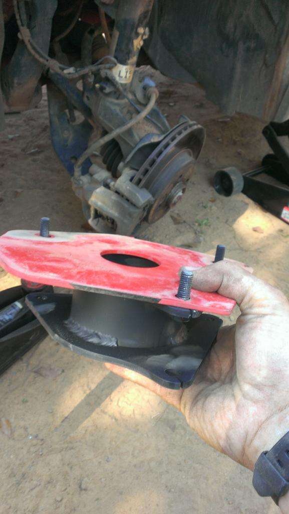

CooperCRAP lift kit installed on my R53!
It took about 4 hours, the only non-standard tool I used was a coil spring compressor. I've got a couple pictures of the process and I'll type it all out later.

I didn't replace anything while I was in there. If I were you, I would check the strut tower mounts for cracking in the rubber. If you hit a lot of pot holes or live on a dirt road like I do, they don't last too long and you're already in there to put in the lift.
Also if you want to put in some strut tower mushrooming prevention that would also be a good time. Something like these plates I already had in there. I think they might be CravenSpeed's "Underators", but I can't remember.
