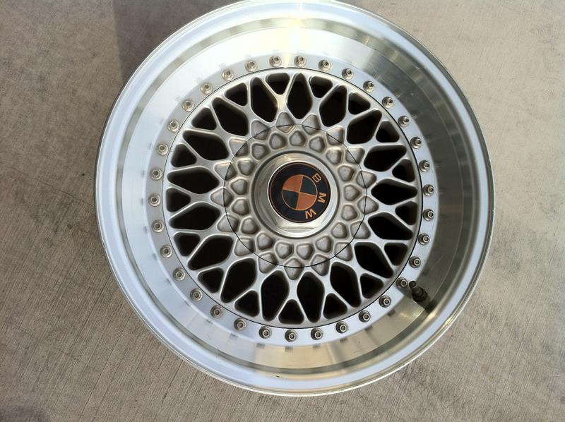

Ok I've been standing by watching people place wide rims on lowered vehicles all the while feeling left out. I love the look and I'm near 50yrs. I just realized I have a set of old school staggered BBS 16x8/16x9 2pc rims in my garage from my old 635csi. They're 27y/o. Now I know someone out there can tell me if they'll work on an R53 S. Other than getting the correct adapters and new clear coat (or Gloss Black powder) what's gotta be done?
STANCE: I know you're out there.

Those are actually three piece wheels made by BBS. Check the back for stampings to indicate their offset. That will be the deciding factor as to whether you have the room for adapters or not.
Edit, just noticed you posted a pic with the stamping. They're et24 which is too low for adapters. You could have them filled and redrilled but some people don't like the idea of that.
Rally: 4 lug to 5 lug conversion won't work?
what about these?
Bolt Pattern: 5x120.65 Rim Width: 8.5
Rim Brand: GM Rim Diameter: 16
Manufacturer Part Number: OEM 1985 Offset: 32 mm
Rim Structure: One Piece Number of Bolts: 5 (5X120)
Not with the use of adapters. Adapters generally lower your offset atleast 18-25mm which will make those wheel offsets too low.
You could convert your hubs to 5 lug as I have done, but to get them to 5x120 you have A LOT of extra work and machining to do because there's not enough room to fit the 120mm PCD onto the stock hubs.
