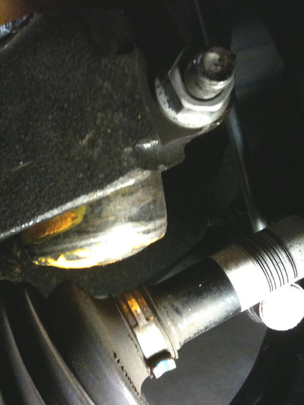

vicj...saw your post on the other thread. I can almost guarantee that your struts are not fully dropped into the collars. What you describe is identical to what happened to me. I wound up taking the car in for help at a suspension shop where I've gone before. I was told that it's a difficult fit. They used floor jacks after cleaning the inside of the collars with emery cloth and applying silicone grease.

vicj...took a couple of quick phone shots of the fully seated strut. I think you can see how far below the collar it is.

Thank you for the pics. Mine are installed correctly. That's not the reason.....hopefully someone else has some ideas.
