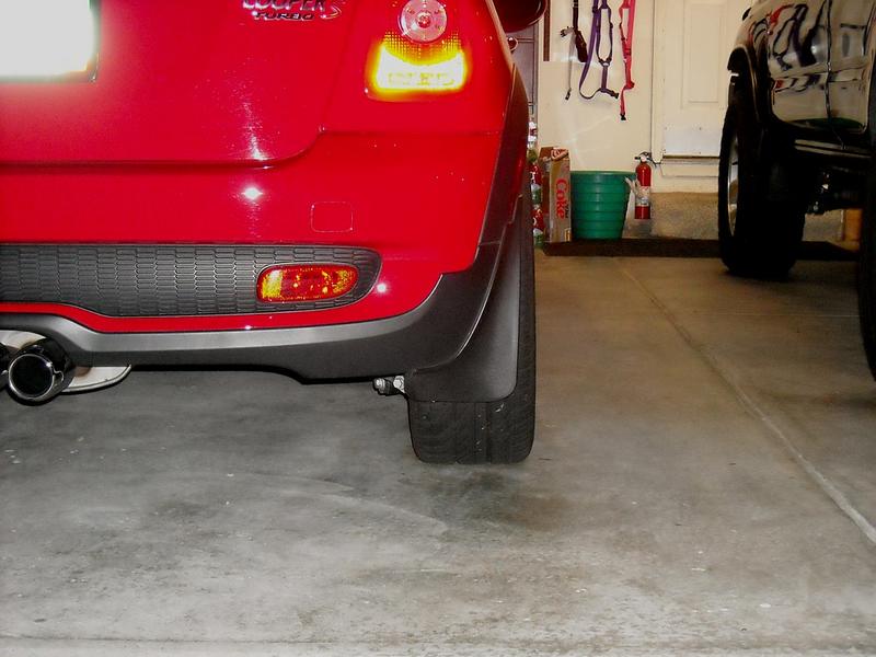

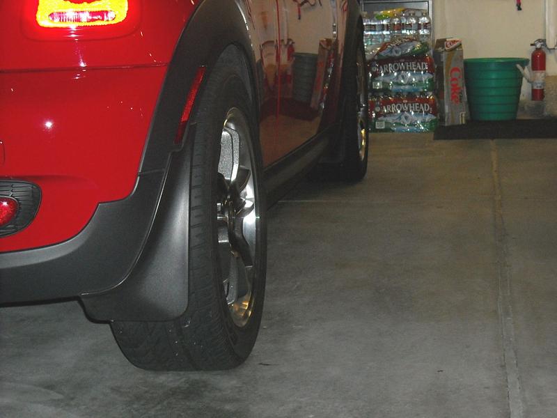

I put TSWs on mine a week ago, but haven't been to the alignment shop yet. Letting them settle a bit before going, but...
I've hardly a difference in the camber to be honest. Rears, maybe a touch more camber, but it really isn't noticeable when looking at it from the rear. Sure, there's camber, but it doesn't look like it has a whole lot more than before I started the springs install. Fronts seem to be bang on, I see no concern there. There's probably more camber there than what there was, but it's not like it's looking like a hoopty, barely a change in my eye...and I've seen some lowered BMWs with a lot more rear camber than I have.
I'll still align it in about another week, more concerned about the toe more than anything. But as she sits, she drives like a dream without any noticeable effects except for a better ride.

You can judge yourself too, I JUST took these, so the quality isn't 100% due to lighting in the garage and dark outside.
TSW springs on OEM struts, unaltered by an alignment (yet). Picture to the far right was taken a couple of days after I was done.
I've read many times on here there's a little adjustment on the stock setup, guess I'll find out when I go in for my alignment. But I'm not overly concerned, it's not that bad really.

that looks just like stock. thats great thanks.
