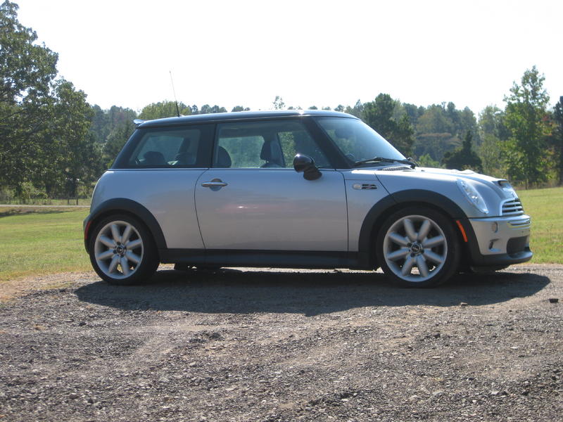

I thought I would put a period on my part of this story.
I could not wait any longer for the corrected TSW springs to be manufactured, so my defective springs have gone back to Way Motor Works. I replaced them with H&R Premium Street Performance springs (green) sourced from Tire Rack.
Below is a picture of my car with the new springs mounted. The car is riding on 215/40/17's that are worn almost slick. There are IE fixed camber plates (new with the H&R springs) up front, & Hotchkis adjustable control arms in the rear(before alignment).

I thought would put a period to my part of this story.
I could not wait any longer for the corrected TSW springs to be produced, so my defective springs have been returned to Way Motor Works. I replaced them with H&R Premium Street Performance springs (green) sourced from Tire Rack.
Attached is a picture of my car on the H&R's. The car is a 2006 MCS riding on 215/40/17's that are worn almost slick. There are IE fixed camber plates (new with the H&R springs) up front, with Hotchkis adjustable lower control arms in the rear (before alignment, so rear camber is still a little extreme).
Sorry, guys. Duplicate post due to delay on the first one showing up.
