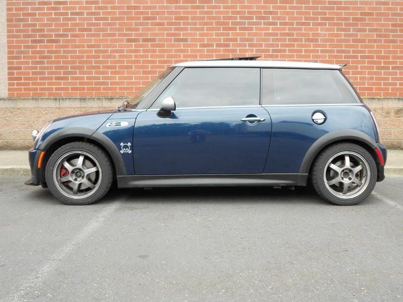

*finally have pictures uploaded. This is after about 2000 mi on the v3 springs, with Hsport camber plates. Tires are 215/45/16.
Yeah, my stance looks pretty similar.

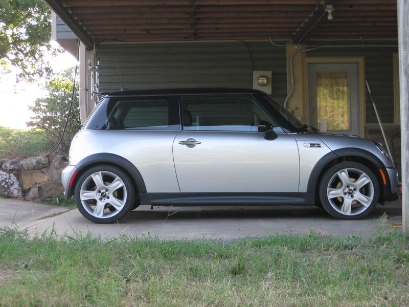

MCS with the aforementioned TSW springs, shocks are OEM. M7 strut tower brace with reinforcements plates.TSW springs - do they settle?-mini.jpg
