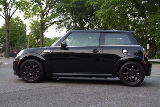

It definitely is, especially since its a lease, I'm just thinking about lease end and having to put all of the stock parts back. Makes me wish I would have bought instead. I might just go with new wheels without a drop. I messaged the owner of a Mini with Tean Dynamics Pro Race 1.2 wheels that look really good and it looks like he's on stock suspension. Check out it here https://www.northamericanmotoring.co...se-wheels.html
It's the blue one half way down the page from "MiniEnvy." I think it looks good and if its stock suspension I'd be happy with it. Here is what my car looks like now
