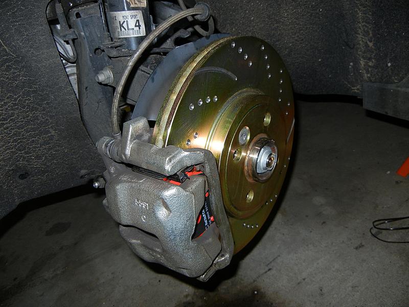

Install was a disaster! When I thought all was done, I happened to notice there was an "L" by the part# on the box one of the rotors came in. Dug the other box out of the dumpster and there was an "R" on it. Nowhere in the instructions is there mention of a right and left rotor and the two look the same. Guess which ones I put where. Got to do the job twice ! BTW, an old brake man warned me about new rotors. Clean them thoroughly TWICE with brake cleaner and rags before install. There is an oil based coating on them to prevent corrosion while in storage. Makes bedding in a lot less dramatic! The pic shows the job done wrong. Note the direction of the curve of the slots. Good Luck!

Dwight I would have made the exact mistake. It never fails. Thanks for the tip!
