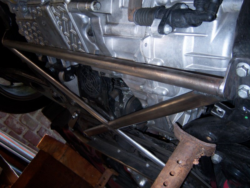

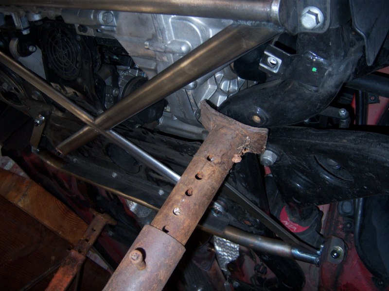

As promised here is a picture of the x brace installed on my car;
Also the thing is really quick to install, just have to jack up the car. (Recommend evenly raising the car, not mounting the x brace while the car is jacked up from one side only.)

I like this!! You know I am going to add this to my car. I have the lower trapezoid brace and the GTT mid-brace. I think this just adds more stiffness to the front-end. My car is going to end up looking like a ladder underneath. Add this to my JCW springs and FSD shocks and I think I have a nearly perfect street setup that shouldn't compromise comfort yet still improve handling.
I had bought a Mason upper strut brace to put on my car but it will not work with the GP intercooler as they will hit. This resolves that delimma and improves upon it.
Since this goes forward under the motor it looks like you should be able to use this with the Mason bar or the X-Brace.
Anybody have any straight on shots to see how it affects ground clearance? That would be my only concern as I have the ditch style curb at the end of my driveway which already prevents me from pulling in. I have to go at an angle. Glad my driveway is long enough. Just want to be sure I wouldn't scrape.

Ran my car at the autocross this weekend. Felt really good. That is about the only way to say it. The x-brace is just better, with it, had some hard turns and felt no chassis flex whatsoever. (It always helps when you come in first, right?)
As for clearance, my track car has been lowered 0.75", and it has hit twice on the road. But both times were unusual. The last time, there was a bubble in the road, that was under the middle of the car, and it hit it. But rather that that the gear casing right ?!! The other time, I was doing a night TSD Road Rally, and had pulled way off the road at a checkpoint for a course worker, and had the two right wheels off the road and on dirt.
But on a car that has not been lowered, it should be fine, as Andyroo points out, the horizontal "little lip skirt thing" is lower - (you can see that if you look close on the pic I posted above... )
Skid plate should be fine going over the x-brace.
