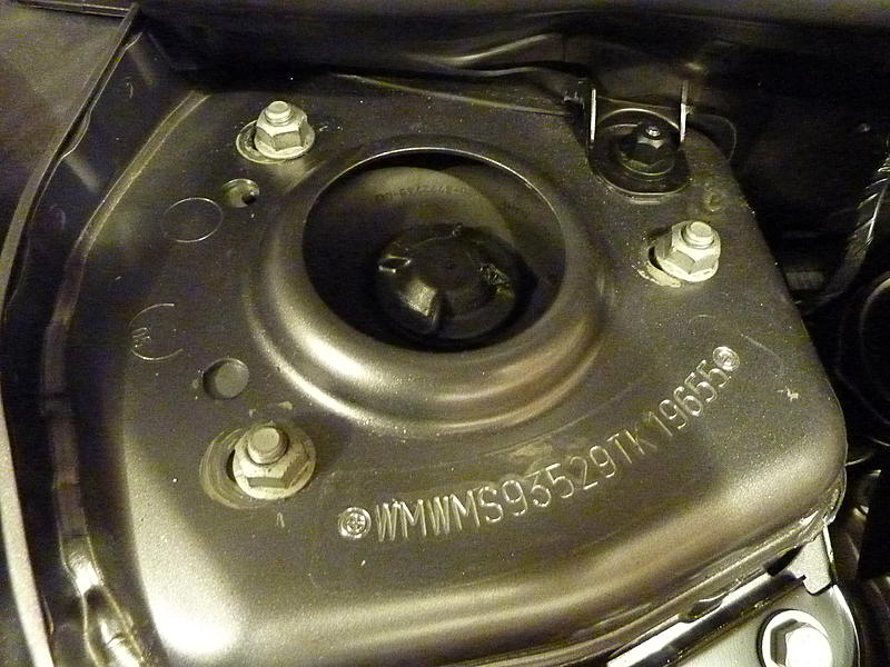

Check the top of your strut towers inside the engine bay. One of them is going to be slightly mushrooming. Look at both from a squatting position so you're looking across the top of the tower from the side. Is one side domed up a little more than the other? If so, there's your problem. Do a search on mushrooming and you'll get all the info you need to fix it. Feel free to PM me also if you have any questions, I've already been through this.
Chad
Chad
Not Sure???
OK I gave them a look and it doesn't appear that to be the problem but I'm no expert.
I used a ruler and a level along with the method above and there seems to be no difference from right to left. As far as I can see none of the metal looks dented, dinged or uneven.
Remember the car is new with only 700 miles on it. Unless the car was wrecked at the dealer ( I didn't see any evidence of repair) or was one of those cars that was screwed up on the assembly, I don't see the towers as being the problem. I could be wrong again I'm no expert.

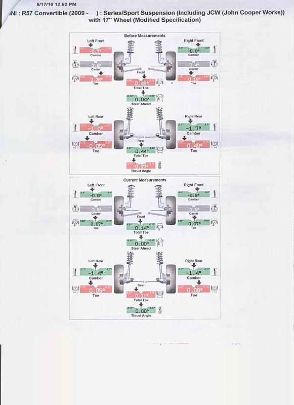

Alignment
Both struts are pushed toward the driver side (left side). Maybe a little hard to see in the pics.
If I push the driver side inward it would give me more negative camber. At the moment it is set at -1.2 degrees.
The passenger side is already pushed inward as far as it can go. This side is set at 0.1 degrees.
I guess I could drive the car some more to let the springs settle. How would these settings affect tire wear?

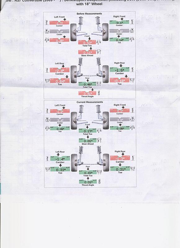

UPDATE
Ok I spent a few hours Sunday working on the car.
First I took some measurements to reference the current position of the front wheels using the old school method (a 2 foot square - three foot strait ruler - string and a small weight) .
After I had all my measurements, I removed the front strut assemblies and re-did them. I also took my dremel with a high speed carbine bit and extended the elongated holes inward (on the passenger side) 3/16 of an inch. Before re-assembly I put a little of clear rust free on the area and let it dry.
I re-installed the struts and set to my measurements. Drove the car to test for problems - all was good.
Took the car back to Firestone today for re-alignment. This time with better results. The tech was able to adjust the front camber to -0.09 on both sides. Front Toe to 0.07 on both sides. The rear camber he set to -1.4 on both sides and the rear toe to 0.05 (left) 0.06 (right).
The tech said there was more room (spring clearing the shock tower on the passenger side) to dremel inward if I wanted more negative. I told him I would think about it. I'd like to drive it around for a while and see how it feels.
So I took the car for a nice ride and it drove great.
Anyway I don't know why or what caused the front camber to be off by 1 degree. After reading many posts I know I'm not the only person who's had this problem. I chose the dremel solution (like others have) because I'm not sure I want adjustable plates. Some say they give a harsher ride and more noise. Both I don't want. I also spoke to several people who develop the plates and two have confirmed the redesign of the shock towers (at least for the R57) does not allow room to adjust the allen screws from atop. Some folks have cut their towers but I'd rather not. So for now I must compromise.
