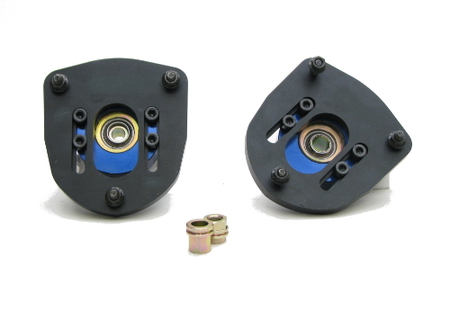

Does anyone have input on the set that Promini sells?
see pic and link
http://www.promini.com/product-exec/...arch_model/153
There for an r57

Hmmm. Half the price as everyone else. Wonder why?
Look carefully at the bearing and compare it to other plates. It does not say it is a full ball and thrust bearing setup. It does not look like it either.

Promini is part of BMPdesign. There have been designing and selling BMW race stuff for longer than I can remember (at least since 1980s).
This is the same basic design as some of the three other adjustable plates out there, namely IE, KMAC and Voshlag.
Voshlag is the most heavily built and most expensive ($430). Then comes KMAC and IE ($275) which is about the same price as the Promini.
I think none of them are DOT approved either. In fact, almost all the Mini third party stuff is not DOT approved either. For racing only, many times means that it does not have the rubber (or otherwise) dampening so it is noisy and harsh. But this is product dependent. Most vendors do not want to assume any responsibility for any of the stuff you put on your car.

That's good to hear. From the picture, it looks like a simple spherical joint and not ball bearing. Pictures can be misleading. Vendors providing additional text for specifics is really a help. That may not matter on a race car where things are inspected and lubed every week, but street use the bearing design and quality in the strut matters a lot to the feel. My experience, others milage may vary.

Quick survey. Of course, the same products show up with various names on them at various prices.
Vorshag, AST, H-Sport ( R53) , SPC, MiniMania, Ireland, Helix (R53), ProMini, KMAC, and the Dinan simple offset plate for R53 seem to be the list. If I have missed some, please pipe up.
It looks like most of them have a ball thrust bearing below a spherical bearing. Some are OEM, some for 60mm, some offer both. Of course, some struts come with them.

Ok after some more research - and some phone calls , I found out that the plates are made by Ruff / Technik. There's more info as to what type of bearing.

I spoke two BMP and Vorshlag. Both said they could not guarantee the plates would have the ability to adjust from atop on the R57. They have received some reports with issues on some 08+ R56/R55. I could cut the area (see pic) like some others have but I'd rather not. I'm still researching on other manufacturer's.

The Vorshlag plates come with six bolt positions and if you use the four outside positions you can adjust fully without any cutting using a ball head hex wrench.
They come shipped from Vorshlag using the inside four positions, and most do not realize that all they need to do is move the inside bolts to the outside position to get the access you need to adjust without cutting.
The same for the IE adjustable plate that I have, 6 positions, choose 4.
