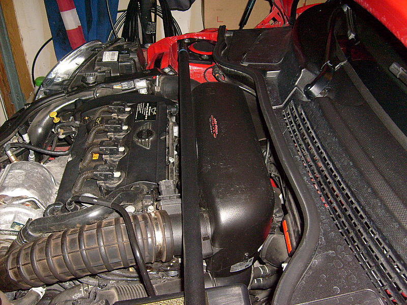

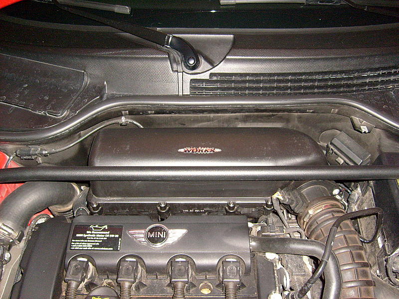

Photos of NM Strut Brace w/JCW Stage I CAI
I hope these photos come through and helps you understand the clearances between the bar and the CAI. I know the clearances look close but I have not experienced any rattles or other problems since installing the NM Engineering strut bar and the JCW CAI. I hope this helps.

Appreciate the pics and the help. I think the bar looks like a good fit.
