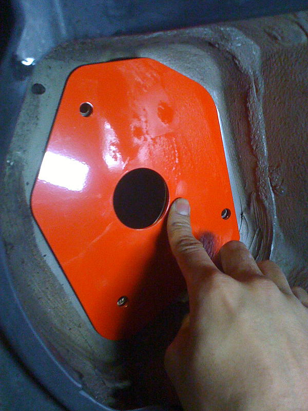

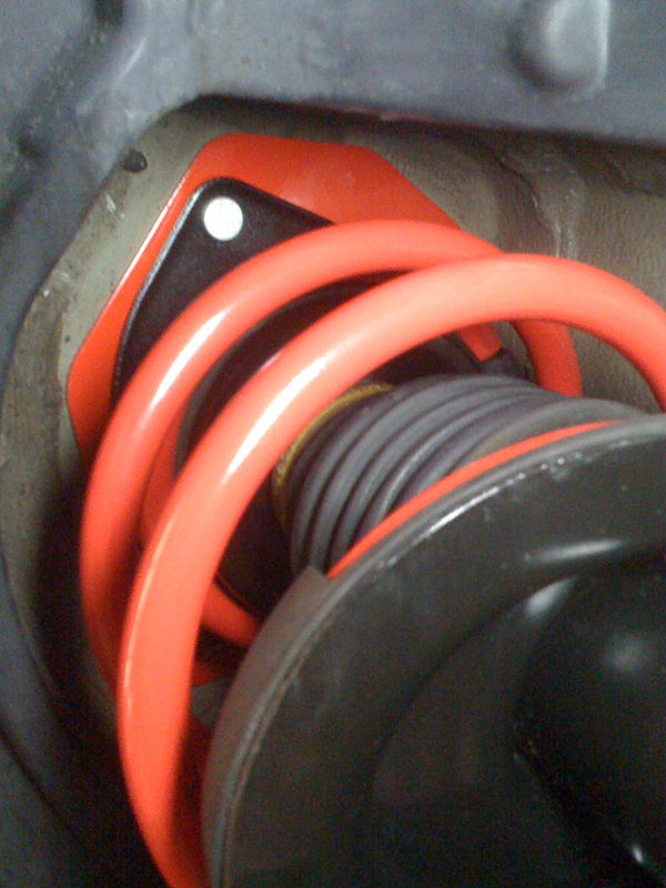

Just installed the Mini-Madness strut tower plates recently. Hopefully this is the end of my mushroomed towers.
