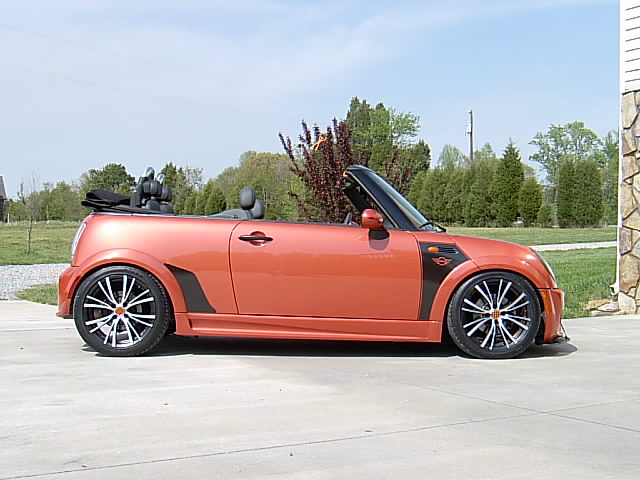

My adjusters pop thru in the boot area.. I'd defently cut for them since you have them might as well use them right!!.. You probably can route them to the area you are talking about. You can get by without the adj. rear control arms for how ever long you like, you'll just be wearing the inside of your tire more then currently.. You could always have you alignment checked after lowering it and see how bad it is. My rear is at -1.0 and doesn't wear too bad on the tires as long are you rotate and flip them about have way thru their wear..
I didn't have to trim anything on my car and I'm over 1'' drop all around easy..
