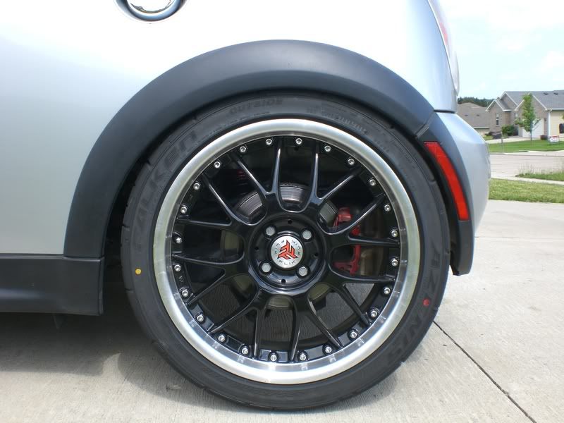

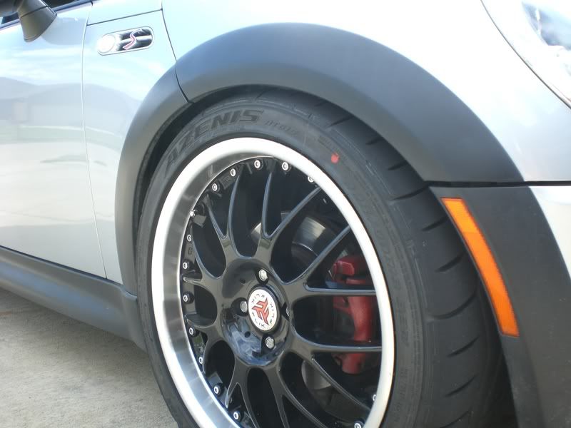

Installed my Megan CO last night. Took me and my roommate about 1.5hr to do the switch out! I was glad to see that they now come with top hats for the rear like the bc coilovers. I have the rear dropped and low as it will go and the front I still have about an inch I can lower if I want. Also, the tires I have are 225/40-18, thats why it still sits high! Here are the pics.

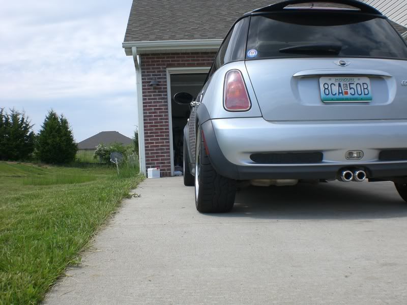

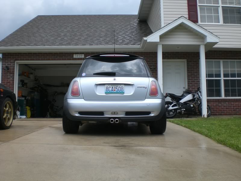

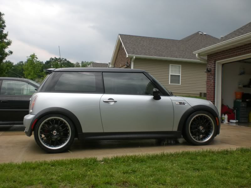

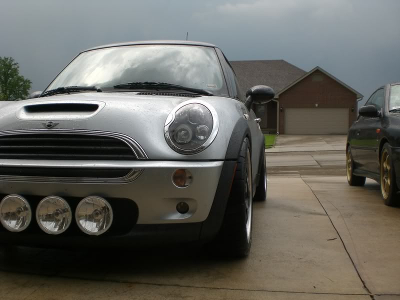

Hey midmomini nice car. Its need to be lowered . Here are some pics of my car after installed. Even with the new spring and shock bodies megan supplied

Here are some better pics I just took with it in the sun and clean. djmini, do you have your coilovers as low as they will go in the front? Like I said, mine are low as posible in the rear and still have 3/4"-1" left in the front if I wanted to.
But with 225/40/18's, you're cheating on the wheelgap!
On a more serious note, I am quiet surprised by how much lower you can go in the front with your current setup. I am guessing you have the early version of the Megans (5kg/mm front springs). Most of us with the v3's are having issues with the front not being able to go low enough, with lots of room to go lower in the rear. In other words, if we were to drop the front and rear to the lowest possible, we would end up with a reverse rake like djmini420's car.
By the way, how bad is rubbing with those fat tires?

Like I said, the rear is low as it will possibly go and the front I have 3/4"- 1" left to go down it I want to. The tires rub in the back. I had to remove the inner fender in the rear and trim on the flares some to make it not rub. I have the v3 with the 8/6 spring combo.
