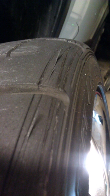

Both, but the rear is more noticeable. The fronts are just rubbing on the wheel arcs, as the rears are rubbing on the wheel arcs and the fender well. Since I can't get a picture of the car on the ground, a good reference is there are two finger-widths from the tire to all four wheel arcs.
This picture you can see where it's cutting into the tire. This tire has been on the rear, as I have recently rotated them.

Here you can see where I cut the plastic wheel well trim and rolled the metal fender, although it still rubs on the fender. Hopefully some control arms can stop the rubbing for good!
Attached Thumbnails 18" rims with 225 tires-imag0122.jpg   18" rims with 225 tires-imag0123.jpg
